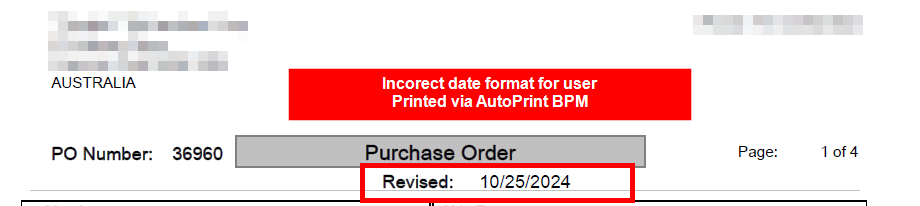

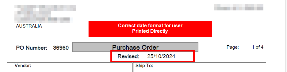

In 2024.1 we have noticed that reports printed via a AutoPrint BPM data directive ignore the format culture of the user and always default to the USA date format. This only happens via a data directive, if you print the report normally everything is correct.
Has anyone else encountered this?
Incorrect via BPM:
Correct (manual print):

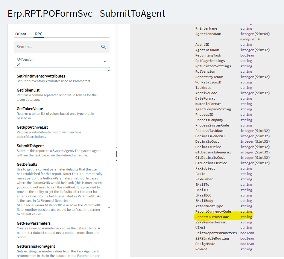

Can you look at the SubmitToAgent method and see if this is set properly in the DD?
Great question @Mark_Wonsil, in both 2022.2 and 2024.1 both the Currency and Culture are blank if coming from a AutoPrint (but it worked in 2022.2).
In the SysTaskParam table I can see that the CUR-LangID/Language ID param is correctly passed in all cases. (ena for Australia)

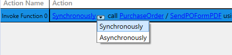

So to make matters even more complex if you instead use one of @klincecum’s great functions to generate and send a SSRS report it will give you different results if it is processed Synchronously or Asynchronously. Maybe this is a task agent issue and not a BPM issue?

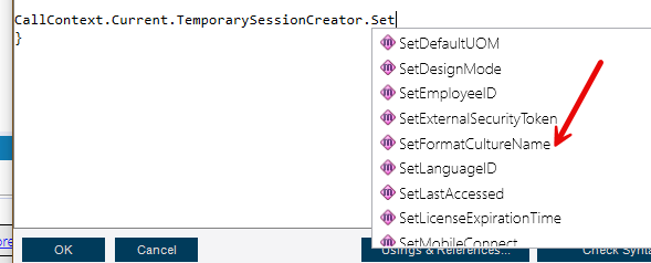

I’d be curious if you can use one of Kevin’s Functions but use the Temporary Session Creator to “force” a change of Culture or Language if it would fix it. It is what we had to do when running “scheduled” functions to grab Company etc. We had to basically pass in the Company / Plant etc identifier as function parameters and then using the TemporarySession we had to activelly “switch into” that for global variables like
this.Session.Company and others to work

For anyone following along support confirmed an issue in PRB0283609.
“Creating a temporary session does not change the value of CallContext.CurrentUser”

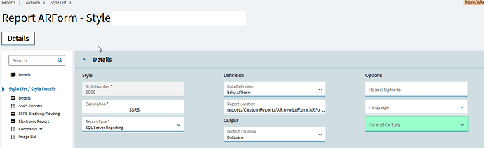

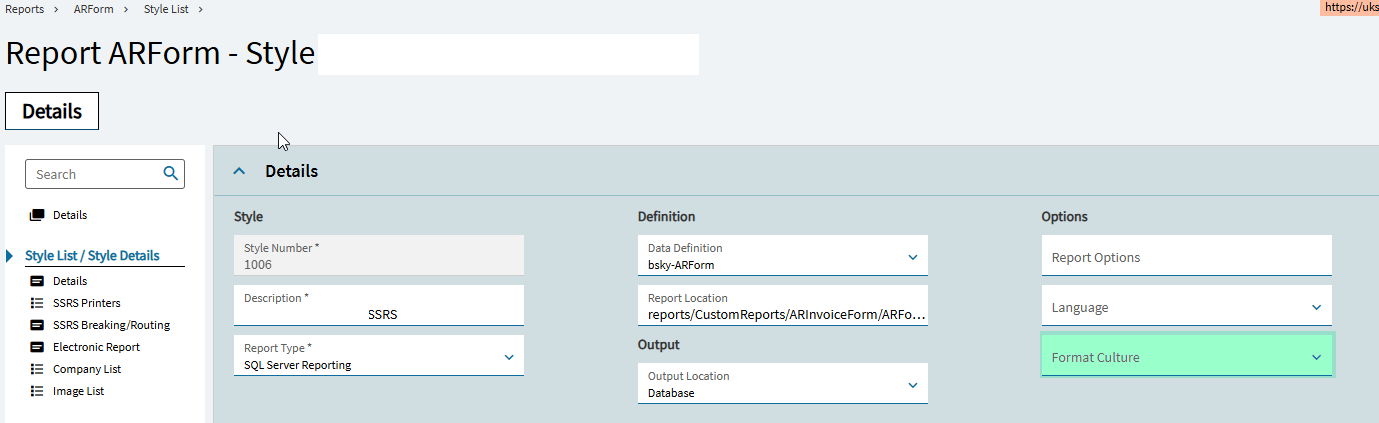

I found this issue for a couple of customers. The solution that worked for my use cases was to set the Format Culture on the Report Style itself.
The use case was that the report style represented a US layout for an AR Invoice - the customer wanted it so that whether it was printed here in the UK or natively in the USA it would always have the US date format, and not follow the user culture.
We found that too, but we do want it to follow user culture so the same style can be used in all companies.
