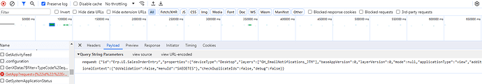

Create a dashboard using classic and generate the kinetic app then make a layer and modify and put it on the menu… Let me know if you get a 500 error on GetApp (in network tools)
You must add a layer and change something e.g add a blank panel card etc…
If you don’t the dashboard will run normally without issues from the menu.
We also have a custom dashboard which will not run in 2023.2.3, receiving the 500 error. Another seems to work fine, so I don’t think its across the board.

We have one known issue that is in the works for a final fix for ga where certain translations being loaded can cause an application load failure, however we’ve only had a couple of instances of it raised so far. One of them was with a dashboard that loads in studio but not from the menu. Likely that’s what you all are experiencing.
If you have examples of applications that are failing to start please make sure you report them to support with exports of your customization so we can review them quickly.
Here’s one example. I’ve compared this to the base and the only difference is the “layers” value inside the array.
