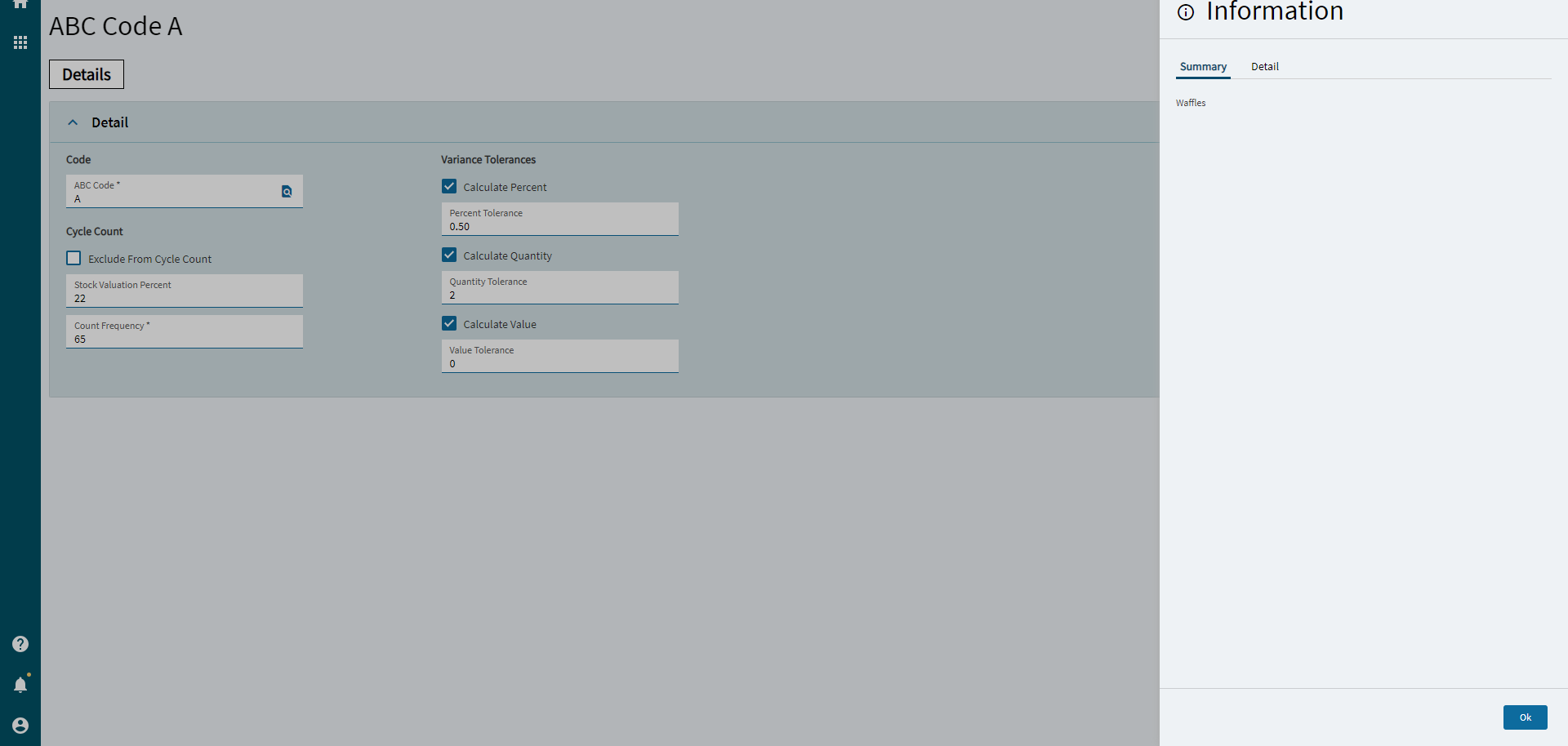

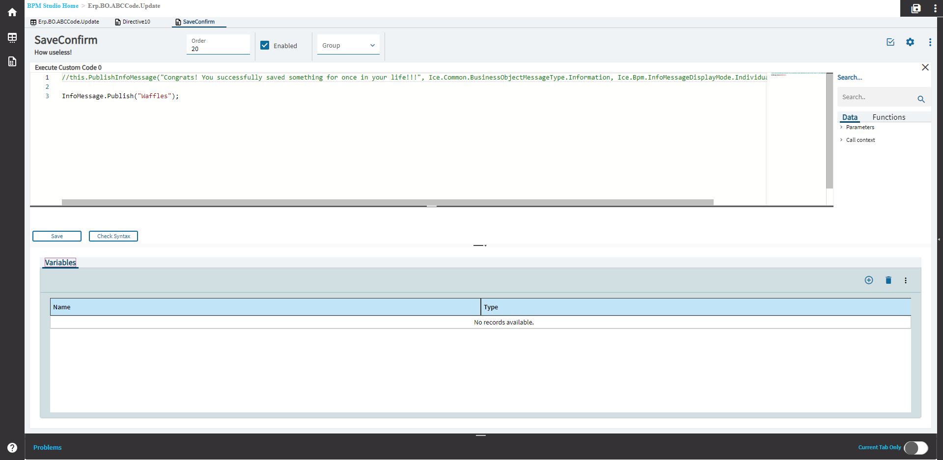

I’m on public cloud 2023.1.5 and can confirm InfoMessage.Publish() did not work before and now it does.
On the topic of which is better to use I really do find uses for both InfoMessage.Publish() and this.PublishInfoMessage() and hope they both continue to work. 99% of the time I just need to pop a simple message without having to deal with other options like the DisplayMode or text on the box header. InfoMessage.Publish() keeps my code more clean and easily readable for the next person to come along especially since the IDE for Epicor is lacking to say the least.

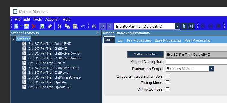

I’m using a method directive on parttran. I’ve tried Base and pre processing. Neither fire and this worked before the upgrade to 2023.1.5
ryan reynolds hd GIF
What is Parttran Basic?
These are the methods on part tran.
And you should NEVER use Base (ok not NEVER, but it’s quite rare that this is necessary)

Post your BPM so we can take a look at it.
