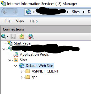

Thanks to @Olga and colleagues, we discovered that in IIS Manager, the “Default” site must be named “Default Web Site” (in case anyone else comes across this same problem and spends a week trying everything else under the sun, except that).
