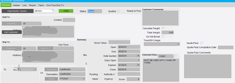

Hi guys - We’re starting to test the upgrade from 10.0.700.4 to 10.2.300.3, and I noticed that our customized forms have issues with overlapping fields (although no errors generated during the upgrade itself). Many of the groups have been shuffled around in Quote Entry.
What’s best practice to fix this?
Is there some way to do it in 10.0.700.4, so it upgrades cleanly? Or do I fix it in our 10.2 testing environment, export out the XML, and re-import all the files every time we refresh (planning on a monthly cadence for testing). Or is this what the Solutions Workbench is for?
We’ve got dozens of modifications… Thanks for the advice!

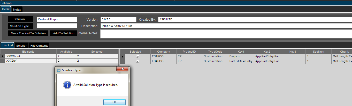

We’re making good progress. Using the ERP Analyzer, I have a list of 60 UI’s that we’ve customized. In our 10.2 July testing environment, I’ve fixed them, and exported the XML files. We have a new 10.2 August environment that I’d like to batch import them using Solutions Workbench, but I’m not sure of the settings to use, and help file confused me.
Here’s the workflow that I figured was needed:
  1. In 10.2 July, create a solution, and turn on solution tracking, and select that solution.
  2. Go through every UI in developer mode, import the XML.
  3. In SWB, move the tracked to the solution
  • This gave me an error - What solution type do I use? All ICE elements? I figure it’s not RDD… Here’s a screenshot from my 10.0 testing:
  1. Use this cab file to import in the new environment.
Do I care about XXXChunk and XXXDef, if all I want is the xml files? I assume it’s Epicor ICE stuff behind the scene, and I should let it do it’s thing…
Can I manually add the xml files to import, or will Epicor not know where to place them? Is that using the Add File > Customization element (XXXDef)?
Is there a tutorial with an example I can follow? I didn’t see anything in the EDU pdf’s besides the SysAdmin Tech Ref that walked you through how to use Solution Workbench.
Thanks for the help!
