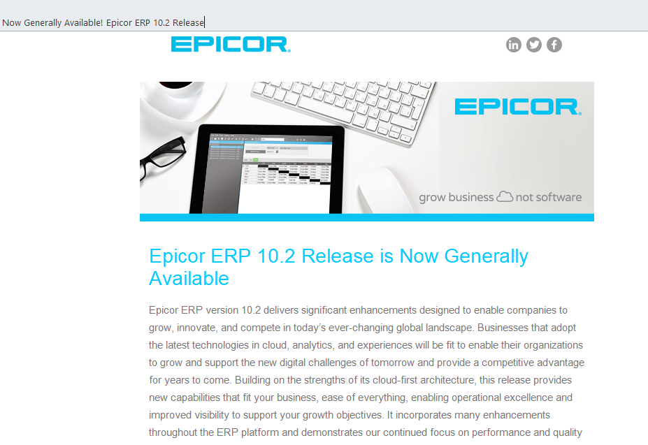

Received the following email this morning around 9:40am that the “Now Generally Available” release of 10.2 is available.
