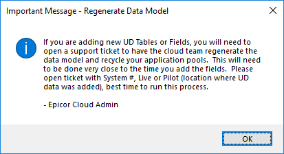

Even on 10.2.200.11, SaaS users get this message when going into UD Column Maintenance:
Mark W.
Ahhh SaaS Ops value added BPM there!
Yes, I’ll just say reviewing and roadmap and safe harbor™ :wink:
