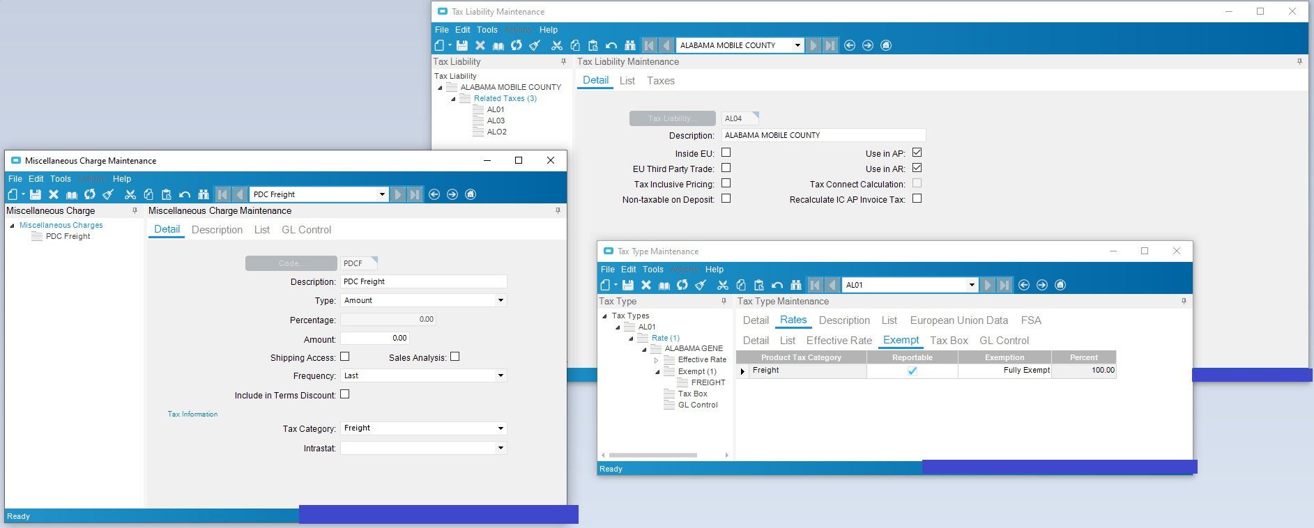

It took me forever to figure this out. It looks like this when you are done:
Point is, every single tax type in Tax Type Maintenance needs the Tax Category listed as exempt if you want that tax region to be exempt.
Thanks for the replies. I broke it down further and found that an integration I wrote recently creates orders that consistently tax the misc charge that shouldn’t be taxable. Orders manually input in the UI are wrong in the same way as my integration. Orders created by an older integration occasionally have the correct tax amount, but usually have a different tax amount that is neither what it should be, nor what it would have been if the shipping were taxed. I suspect that the only problem with our Epicor setup is what Jason identified, and that if I dig into the older integration, I’ll find some stupid hack where it’s trying to override what Epicor is doing and usually getting it even more wrong.
