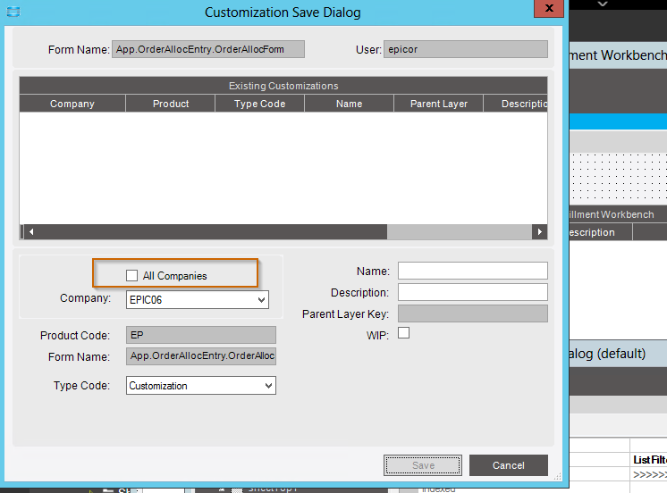

Did you mark your customization as available to “All Companies” when you were saving it?
No but there is only one company.
But I did that and it shows up now.
THANKS NATHAN! BUT…

Short-version:
This behavior in 10.1.600.x is the current correct/intended behavior and there are no plans to change it back to the behavior of pre-10.1.600.x releases. There were changes made to introduce consistency in experiences between our Cloud and on-premise customers.
The official process would be to resave all customizations with the “All Companies” box ticked if you wish to have them be selectable to the main menu.

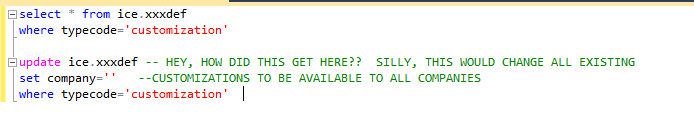

Wouldn’t ice.xxxchunk need to be updated as well?
That a good idea–please feel free to open a Support ticket and request that enhancement. It’s a very reasonable request.
I just tested and you are correct; both xxxdef and xxxchunk need to be updated. My apologies.
