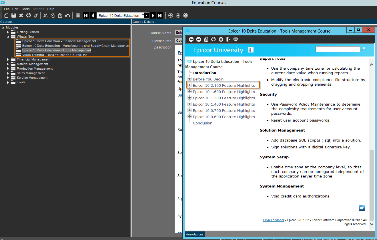

If you haven’t done so already, I would recommend installing 10.2.100.x and enabling Embedded Education to get access to the big changes for Financial, Manufacturing and Supply Chain, and Tools. We provide the highlights for each area and that should help you build a case for upgrading if there is something listed that your company would benefit from.
