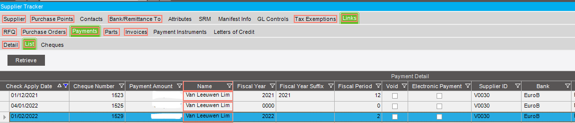

Our payments clerk keyed in payment before we set up a new fiscal year. It resulted in an entry with 0000 fiscal year and 0 Fiscal period. Demo below:
It appears only mess up my currency revaluation report, as GL and accounts appear to be ok…I think.
I need to reverse that particular transaction, but it is already reconciled. Do I void it? I’ve read in some post here that voiding reconciled transactions is not possible.
Or is there any other way?
Thank you muchly,
E
