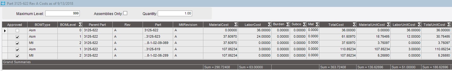

When viewing the production cost for an assembly in Method Tracker it noticed that there are some manufactured parts that are coming in without any Material Costs associated with it, only Labor. The raw material components that these sub-assemblies are made of do carry costs (we are FIFO). I can’t tell that is rolls up these Material Costs anywhere.
I think the material cost is at that level. So it’s getting the cost from the lower levels. Is the Assembly with 0s all assemblies in it? The screen shot looks like the level 1 (1 level down) is all assembly. So the material cost is on those levels, because below them is the materials.
