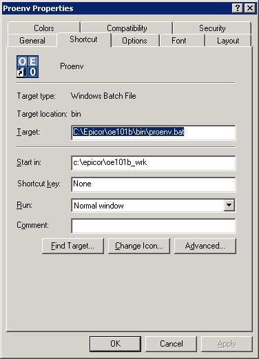

And as mentioned by another user… are you able to get into ProMon?
Or… how about ProEnv - do you have a shortcut, can start that (cmd line for some Progress functions)?
If you can get into ProEnv, I would suggest trying to make a backup before getting too adventurous.
Ref screen shot - where path may or may not match your system
In the ProEnv window (like @bordway showed),
a. Type prompt and hit enter
b. Type E: and hit enter (you’re probably alread in the E: driv, bu this won’t hurt.
c. Type cd \epicor\mfgsys803\db and hit enter
d. Type asbman -name MfgSys803ProcessServer -kill and hit enter. This should end the ProcessServer App
e. Type asbman -name MfgSys803TaskAgent -kill and hit enter. This should end the TaskAgent App
f. Type asbman -name MfgSys803 -kill and hit enter. This should end the main App
d. Type dbman -host localhost -port 20931 -database MfgSys803 -stop and hit enter. This should stop the DB.
If you got an errors, report them back to us. If not, try restarting everything by entering each of these on the ProEnv window (one at a time):
a. dbman -host localhost -port 20931 -database MfgSys803 -start
b. asbman -name MfgSys803 -start
c. asbman -name MfgSys803TaskAgent -start
d. asbman -name MfgSys803ProcessServer -start
