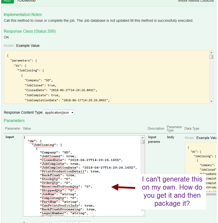

Using REST to close a job from PHP
“Simply create this JSON Object”
I’m lost how and what do do at that step. What JSON object?

I don’t know where the POST fields go or how to package them to send to CURL. The example on the API shows a huge list of items as well, how do I generate those?
