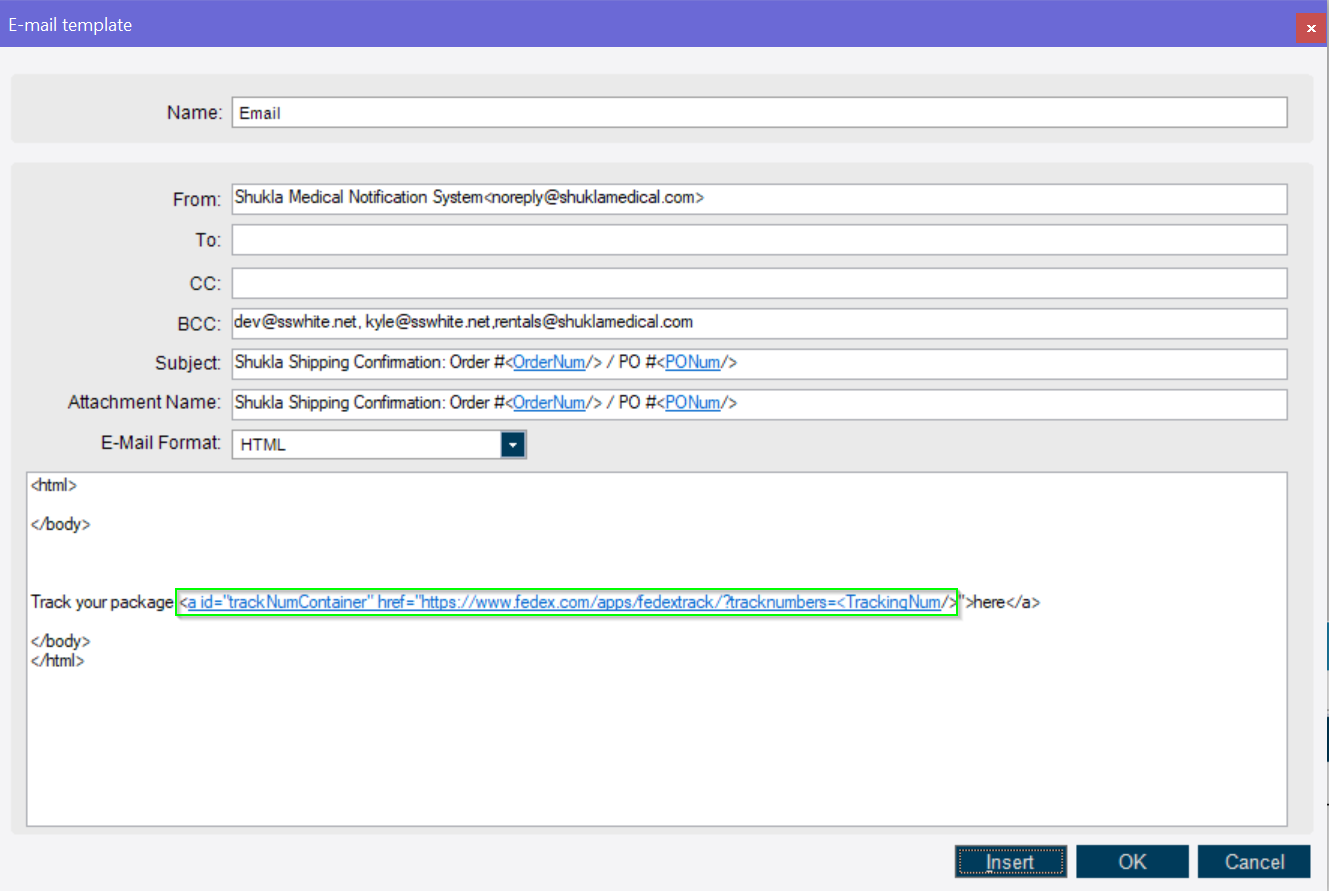

Very good suggestion! However I just tried it and it came out like this:
So close!!!
I wonder if it has to do with the <
and >
characters (from the inserted field place holder) being nested within the <a..>
tag

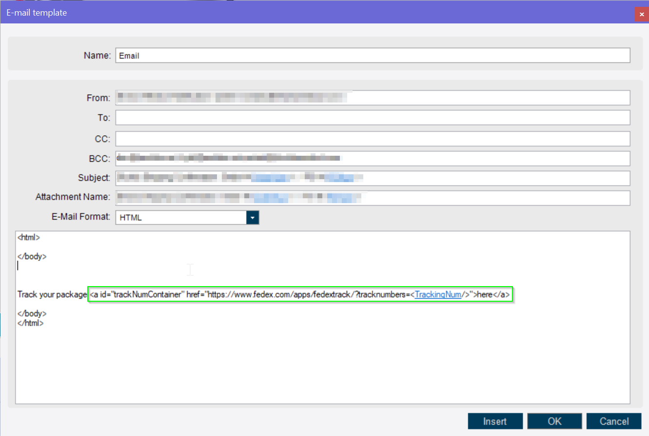

It 100% does. The formatting for the inputted fields from the insert button (on the E-Mail Template) are almost seen as part of the html tag. Before closing the email template, the a tag looks like this:
After opening it back up, it goes to this:
If only the field was formatted to something like ${Epicor_Field}
