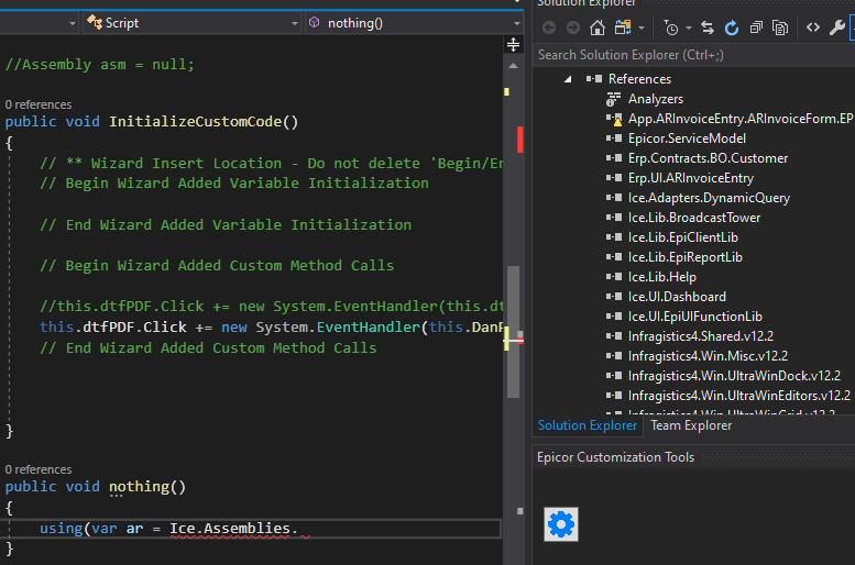

Even when i use your (amazing and priceless - thank you!) plugin I can’t find it:
Server renderer hmm that’s on the BPM server side in the UBAQ
If you wanna do it client side/ external you’ll have to instanciate your WCF proxy (as outlined in the post above )
Or use REST
If I have some time I’ll try to give you a more concrete example tomorro
Been slammed today
No problem – I found the correct DLL file so that’s ok… I’m plowing ahead with my old way and trying to get REST going at the same time… Lots to learn lol

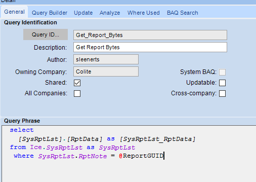

Could you not do the same with this query?
I’m only wondering why you would need to inner join with SysTask.
