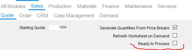

Not sure how the integration works, but there is a checkbox “Ready to Process” at the order level that determines if tax should be calculated. The default value comes from company configuration.
Now, the idea is for the tax to be calculated as the last step, or if the order requires a lot of changes to turn it off first.
So if the integration is creating the order and adding lines and sending every change while the Ready to Process flag is on, it will call Avalara as many times as it needs.
