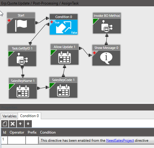

OK, here’s the breakdown of the TaskAssign BPM.
Condition that is enabled from Pre-Proc BPm that checks a bunch of things to determine need.
Get the Task DataSet for Seq #10. The Key1 value is set by the other BPM that creates the case and is fired off just prior to this one.
3)These are the three value ‘setters’ for Sales Rep Code/Name and Allow update. The Name/Code come from the ttQuoteSR table that is in the current dataset open because ALL of this happens as part of Quote.Update.
- and Lastly, the Task.Update
