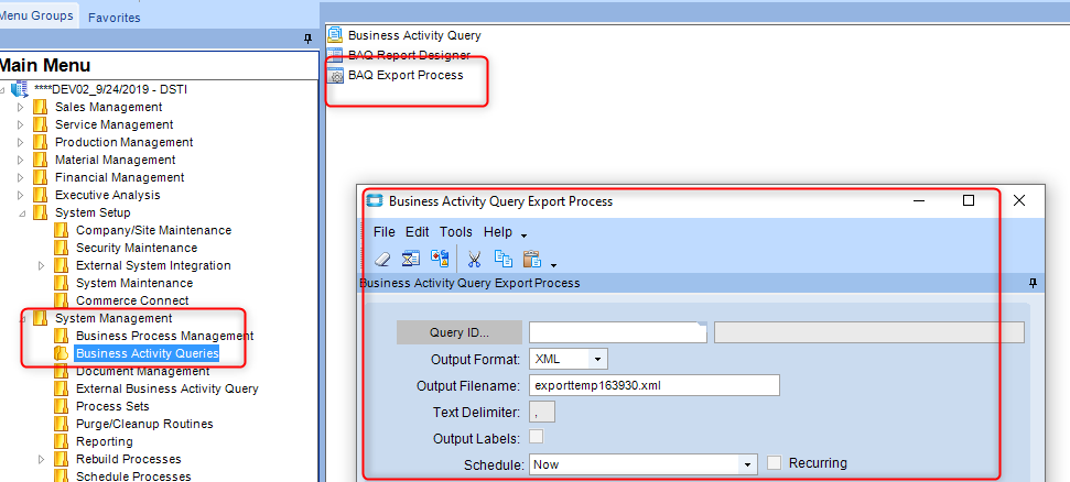

I’m not sure if this would work on your end but this might be another direction you could try?
Yeah I think this is the right way to go, kinda mixed up BAQ Export Process and Scheduled BAQ Report with my previous post…
So this would export a file…then I would manually put the value back into the system before the BAQ Report runs?
@adamk Yes this would export out a file base on the schedule. Though, when I think about this again this might not be a good direction.
