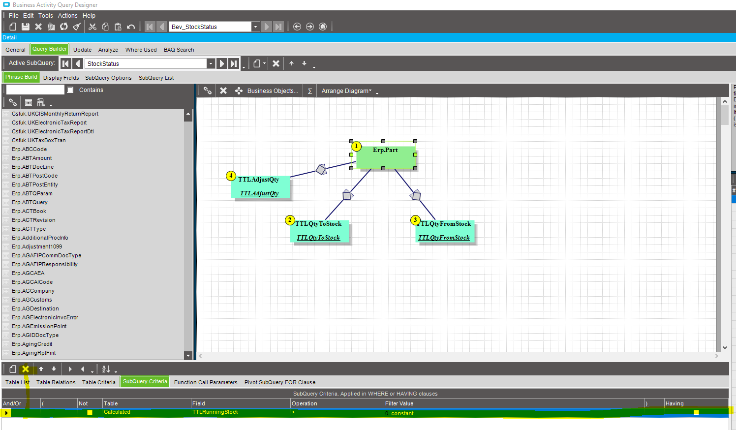

Hi @Hari_Dutt,
finance module is not set in my environment, so i can not help you on that, however if i were you i would validate what cost method you want first, then see where Epicor is calculating it, even if that happened -on the fly-, it is much easier to capture Epicor view values at any UI and save it on UD fields than trying to work out the logic behind each method, i have developed something similar to capture Quote Cost/Unit price values per quantity which Epicor calculate it -on the fly- and view it on the Quote UI only when quantity line selected on grid.
Now with regard to the multiple plants issue, try to add PlantID as another parameter to the query and use it as filter in each of sub-query as well as the top one.

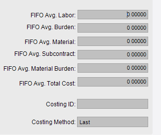

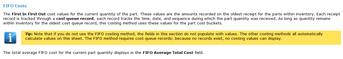

We are using FIFO Method and please let me know how they are calculating ?
In Part Tracker cost is showing 22.880 but in Stock Status Report is appearing 22.873. The part is setup as FIFO.
