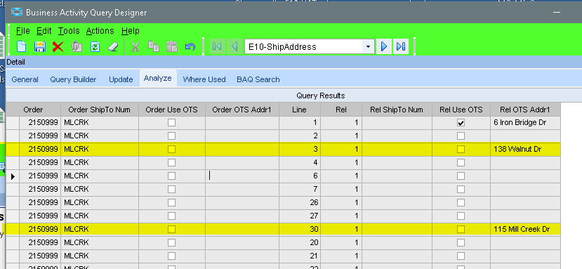

The following shows Line-Rel 3-1 and 30-1 as having data in the OrderRel.OTSAddress1 field, even though those releases are not currently marked as OTS
