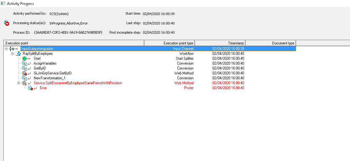

When I drop the file on the folder and CSV file got the below error message
" <msg:req tag=“GLJrnGrpService.GetByID”>
msg:ers
<msg:error type=“unexpected error”>
msg:number2147220990</msg:number>
msg:descriptionUnspecified error: Unknown fatal errors occurred: Client Proxy error occurred when calling GLJrnGrpService.GetByID
Exception of type System.ServiceModel.FaultException1[Ice.Common.EpicorFaultDetail]: Record not found. </msg:description> <msg:source>Client Proxy error occurred when calling GLJrnGrpService.GetByID Exception of type System.ServiceModel.FaultException1[Ice.Common.EpicorFaultDetail]: Record not found."
The Error says it couldnt find the record, what are you passing into GlJrnGrp GetByID
First it has to create GL group in the journal entry and it would create a Time and Expense Entry in the system.
Yes but when you do GetByID that is not creating it, that means you are looking for an existing one.
Where is the Node where you are going “GetNew” and then “Update” (creating it)?
