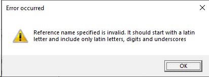

I am getting an error saying the reference name is invalid, any ideas ?
Same message when i use Ice.Contracts.BO.UD33

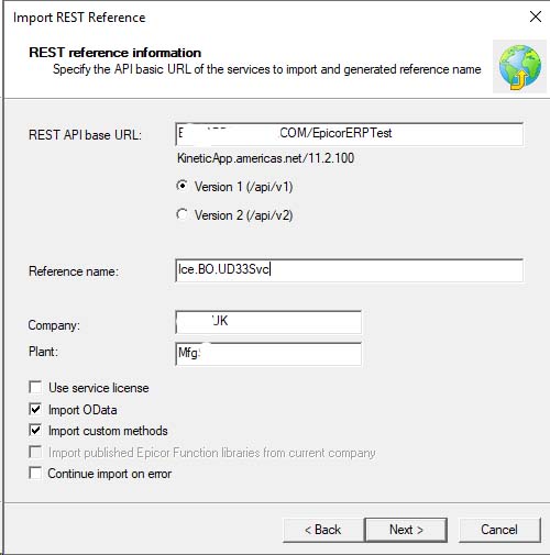

The reference name for REST should not contain periods which you used in the reference name.
Also, unlike .NET or WCF references, REST reference for Epicor/Kinetic may include multiple services (you select which ones to import later in the wizard), so, unless you intend to import just one service, may be better to give that reference a more generic name, like EpicorERPTest, or similar.
Additionally, if you only plan to call service methods, unselect Import OData checkbox on that page.
Thanks, yes - realised I already had the sales order service already so just needed to Re-import on EpicorERPTest to add the UD table to it.
