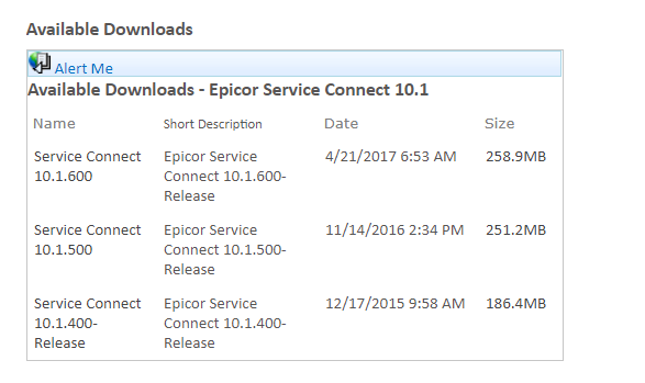

Is the runtime included with the base epicor install files? If not where is the runtime install file located?
I can’t remember where the install is, you may have to download it from EpicWeb?
Yea looking on Epicweb, I only see the main install files not the runtime itself. I’ll keep looking.
I think its the same installer (license vs not?) Not sure may be worth a call to your cam / support.
when you install SC, it comes with Runtime. You need to install the whole SC install because you still need to run the admin console for logs and viewing flows.
So does that mean we have to go through setup steps just to use the runtime?
Correct, aside from the ability to develop work flows it’s the same install as it needs all the system access levels, functionality and configurations to execute workflows.
Seems odd you have to do all of that just to use the runtime, but thank you for the reply.
There is much more other stuff then just the run time. The runtime will let you execute workflows created by someone else. But you will also be able to view logs, view the workflow and other things. At least that is what I have.
