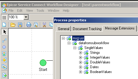

I add a container on the parent workflow.
Then I set it as return schema for the sub-workflow
On the Sub-Workflow I set the Exit node to the Schema I need to pass back to the parent.
I finally add a conversion that with the expected output schema.
and within the conversion you set the values on the DTA section not to the USR
