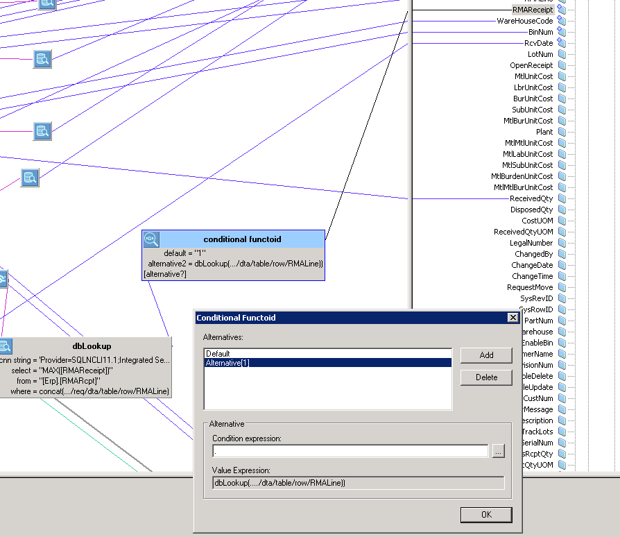

I’m a bit lost on how to use this functoid properly.
I’m doing DBLookup that returns the max RMAReceipt.
I’d like the condition to be if the value returned from the DBLookup is null, then 1, else DBValue + 1.
I have the result of the DB going into the alternate path, but I’m not sure how to set it up from there.
It also looks like the values I have available are from the original schema instead of what the DB is returning.
Anyone have some examples on this?
You have to do the lookup inside the condition. (Not sure if the DB Lookup is available in there… )if it is not, you’ll have to do 2 conversions , one lookup value and map it to workflow variable, 2nd conversion use the workflow variable to apply the condition.

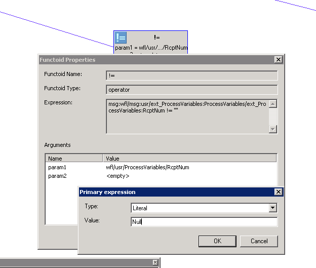

And would this be how to check if null, or do I leave it blank?
Blank would likely be better. Not sure it knows what “Null” is (I can’t recall)

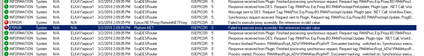

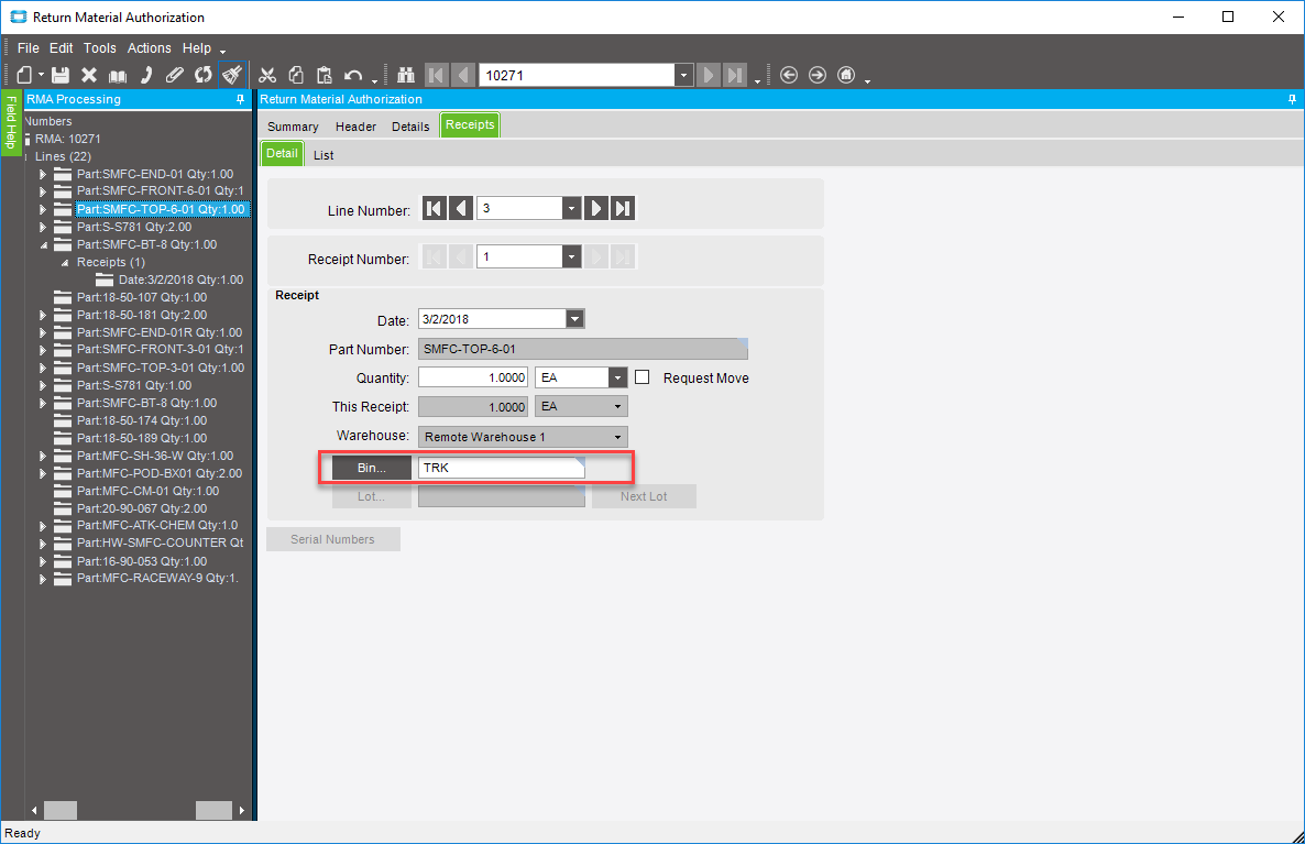

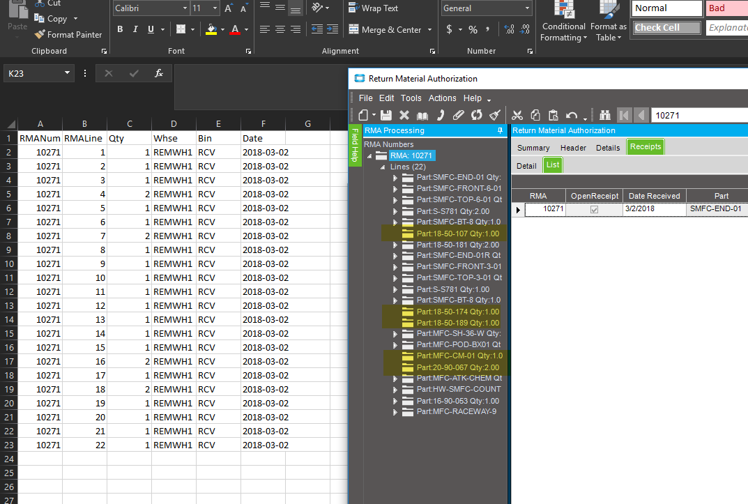

I loops through 90% of them just fine, but on a few it throws an error saying that the bin is invalid. I’m setting the same warehouse and bin on every record.
You doing a subworkflow (one record at a time loop) or trying to run it all in parallel?
SubWorkFlow run synchronously.
What does the workflow trace show? (Error wise)
Actually, it appears to not be taking the bin at all, so I guess the error makes sense if it doesn’t exist in the remote warehouse. They should all be RCV…
Is there something I’m missing as far as setting the warehouse and bin?
I set the following fields on the RMARcpt table:
BinNum
BinNumDescription
EnableBin
WarehouseCode
WarehouseCodeDescription
EnableWarehouse
I’ve tried every combination of those fields with no success.
