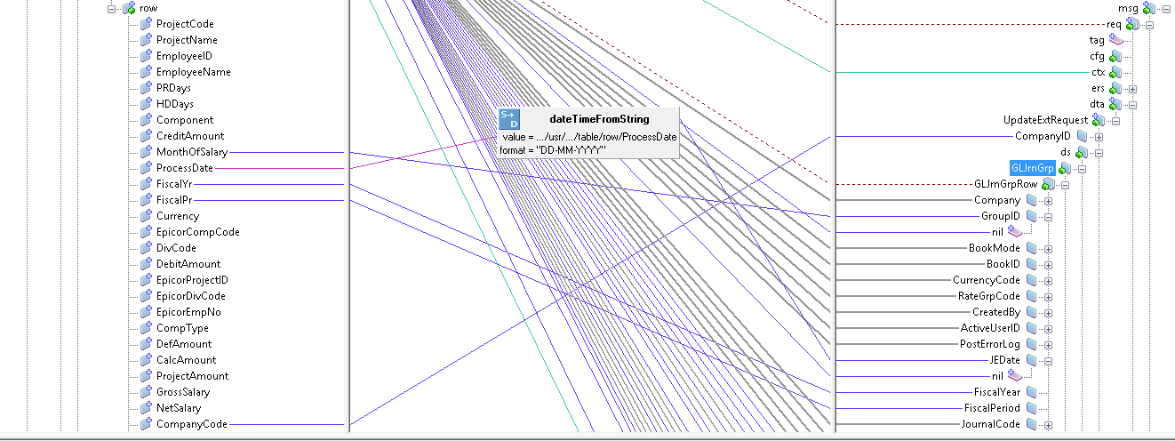

Can you open and post a pic of the “NewTransformation_3”?
yes sure. here you go

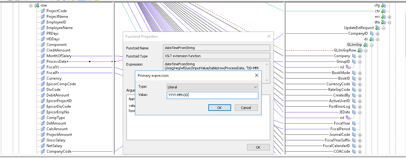

Change the Format in the DateTime function to “yyyy/MM/dd”
. I just changed now. Do i need to change format in my csv file as well. I changed in my csv file as well but getting some error
Input date / time string should match the format string exactly.
You need to consider the capitals letter for identify the Month = MM and lower case for day = dd and the years = yyyy

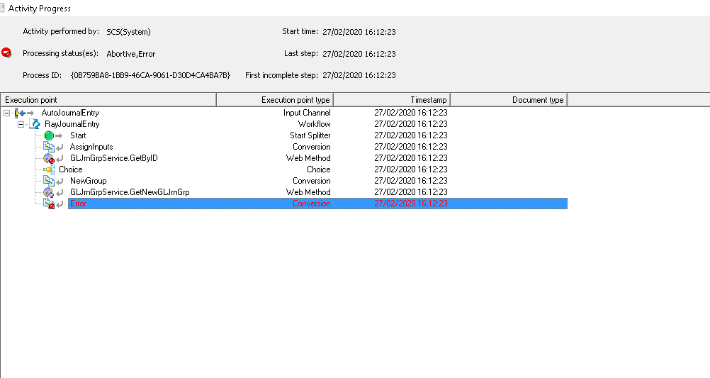

When I checked the error message it shows below any thoughts below error.
<?xml version="1.0" ?> COM 0x80004005 Error during launching plugin CPlugInExecutorNoTran::ProcessXML PlugInExecutorNoTran.cpp 280 COM 0x80004005 LaunchPlugin failed CPlugInExecutorNoTran::LaunchPlugin PlugInExecutorNoTran.cpp 456 COM 0x80004005 ProcessXml failed plugins::CPlugInInfoWF::ProcessXml PlugInInfo.cpp 327 COM 0x80004005 ExecuteObjectInternal failed CScaWorkflowEngine::ExecuteObjectInternal ScaWorkflowEngine.cpp 414 COM 0x80004005 GoThroughScalaProcessorDOM failed CScaWorkflowEngine::GoThroughScalaProcessorDOM ScaWorkflowEngine.cpp 427 COM 0x80004005 CScaProcessor::ProcessDOM error CScaProcessor::ProcessDOM ScaProcessor.cpp 51 COM 0x80004005 CScaProcessor::RunProc error CScaProcessor::RunProc ScaProcessor.cpp 338 COM 0x80004005 CScaProcessor::Process error CScaProcessor::Process ScaProcessor.cpp 671 COM 0x80004005 CPoster::Process error CPoster::Process Poster.cpp 111 COM 0x80004005 CPoster::ProcessAllChannel error CPoster::ProcessAllChannel Poster.cpp 165 COM 0x80004005 CPoster::SendMessagesToChannel error CPoster::SendMessagesToChannel Poster.cpp 330 COM 0x80004005 **No channels assigned to the poster** **CPoster::SendMessagesToChannel** **Poster.cpp** 236
Inside the “Poster” step of the workflow check the properties and verify if you have assigned a channel to this poster, or if the channel is activated

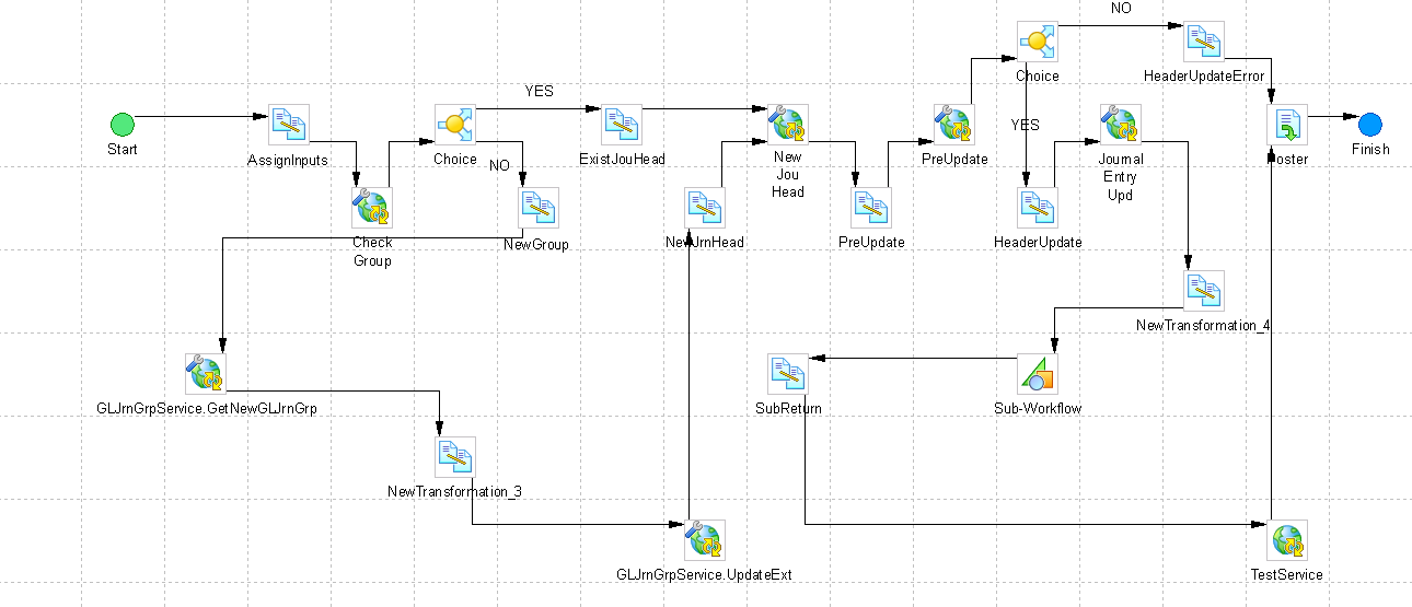

It has not created as separate journal but it created as one journal entry. It suppose to create two separate journal header whereas now in one journal header whole 6 accounts updated. Any thoughts?
The workflow is not developed properly for create different header using the same input CSV file, instead you need to use just one CSV file for each journal
Thank you, It was creating different header using the input CSV. This is time is not creating with different header.
well, in your CSV file you must have a column that Service Connect is using to drop and to know if the row is a new Journal. Can you post a pic of your CSV file.
