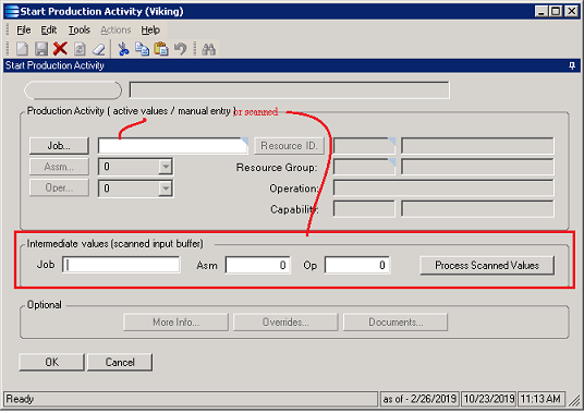

Here’s a screen shot of a custom form… before I cleaned it up for production.
Std and custom fields. button and labels.

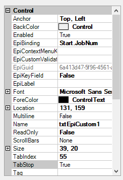

I’m not the greatest with customizations. You said that you added custom fields to the Start Activity screen. Are these new fields that were added to the database that link back to the Job, Assembly, and Operation or are these those fields added in a different way to speed them up?
I used 3 unbound controls to act a a buffer - where I enter/scan the Job/Asm/Op
The button/custom code then starts the activiy using those values.

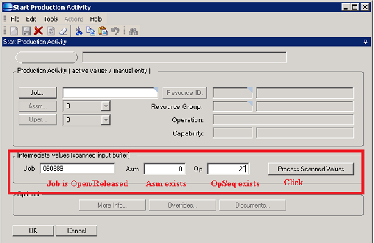

That imported the customizations but then another issue happens. I type in the Job, Asm, and Op and hit Process Scanned Values. Nothing seems to happen. If I click the OK button it says Valid Job Number Required.
Is there something that has to be done with the Process Scanned Values button?
Should just need to enter Job/Asm/Op in the custom fields and click the process button.
There are “End User” instructions included in a section at the end of the Word Doc.
Should have been in that zip?
Are you sure the Job/Asm/Op you used is valid? Since typos are so common, why scanning from a traveler is the ultimate fix.

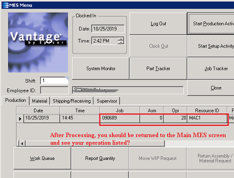

When I click on the Process Button, nothing happens. If I go to the OK button, it then says a valid job number is needed.
The job/asm/op is valid. I grabbed it from the MES program using the standard options. I thought that might have been the issue to begin with but it doesn’t look like it is.
