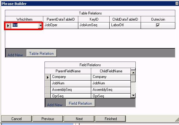

Yeah, if I remember this was tricky on V8/Progress systems.
I think I did it this a couple ways (but… it’s been a while)
1.) Create a view in the database where it is easier to pulls that first LaborDtl.PayrollDate & use that view in BAQs.
2.) BPM on new LaborDtls - to find JobOper related & stamp DateXX if DateXX is blank
And remembered… using “first” in the join can get you there too.
Setting First/Last wasn’t quite as obvious in the V8 BAQ designer compared to E9.
for each JobOper where ( JobOper.JobNum >= ‘111003’) no-lock , first LaborDtl outer-join where (JobOper.Company = LaborDtl.Company and JobOper.JobNum = LaborDtl.JobNum and JobOper.AssemblySeq = LaborDtl.AssemblySeq and JobOper.OprSeq = LaborDtl.OprSeq) no-lock .
