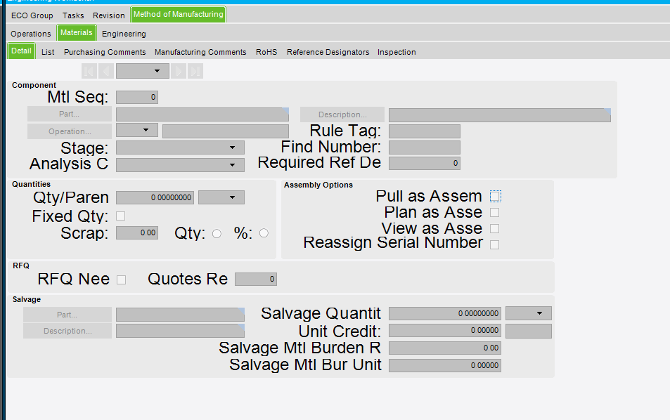

Does anyone have any tips on how to get scaling to work correctly on a surface pro? E-10.0.700.4. Is it fixed in 10.1? I’ve playing with some settings and things change but it’s only different, not better. The opening menus look perfect, but as soon as you get into any of the menu’s they are tough if not impossible to use. Any ideas?

D= try this and it didn’t work , I am using epicor 10.1…400.17 with windows 10 , surface pro 1796(2017), all labels and text boxes are shrink seems nothing has changed.
Scaling is at 200% at 2736 x 1824 , 64 bit epicor
