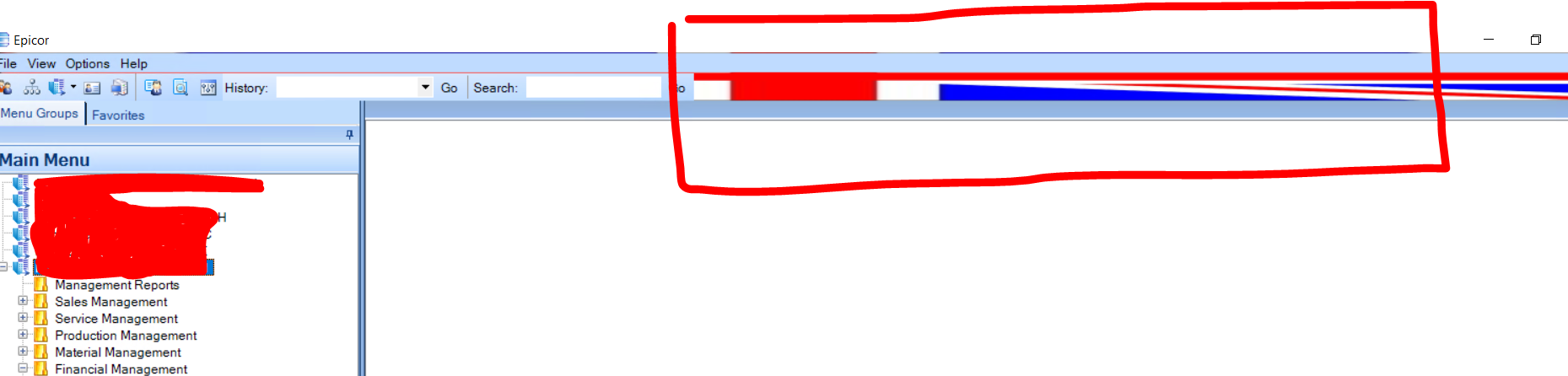

We’ve just created a new company and I need to add a new flag to the top of the screen similar to the other companies as per screenshots below.
This process was done by a previous employee and i’m not sure how to do it, but i’m guessing it has something to do with runtime styler?
