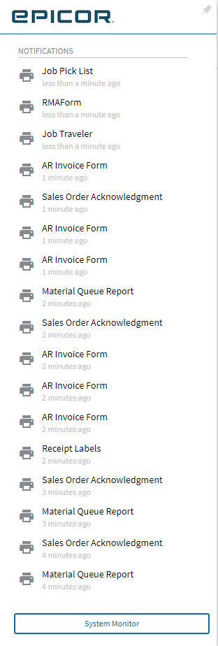

Every time someone print previews a report. It will appear in my screen not theirs! This is happening in our Pilot instance and now our production instance. We are SaaS
I have removed the edge printing agent from my machine and removed it from our local server. I have been modifying reports but I cannot understand how this would affect it popping up on my machine not theirs? The only way they can preview the report is to click the ‘bell’ icon and click on the report.
Please can someone explain to me.
My notification panel… I didn’t print any of these LOL

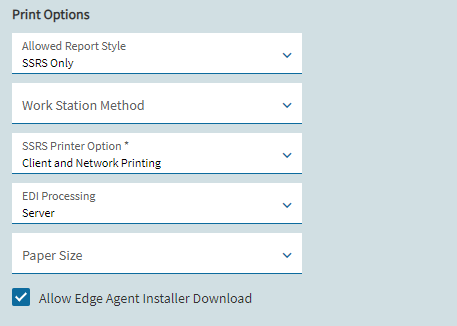

What do you have selected in company maintenance for workstation method?
Blank mate…
Trying changing it to machine name + user id?
I have no idea if it will help you, just, filling that in has solved some strange problems for us so throwing it out there.

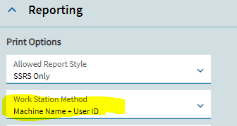

we tried the work station method and set it as follows, it appears to have stopped the issue for us.
