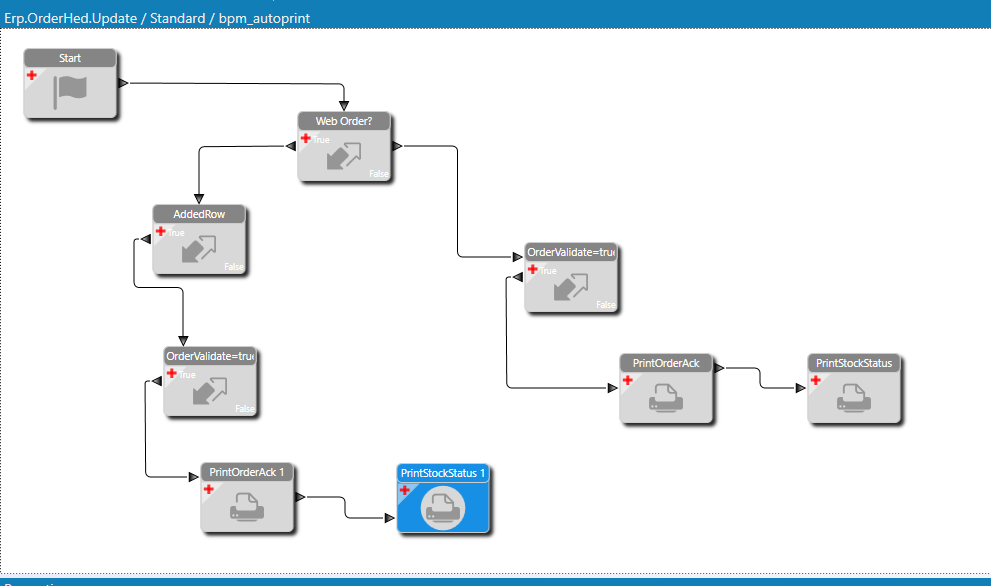

Last we left off, you wanted to push an attachment triggered off of a data directive when a field changes on orderHed correct?
Lay out all the details in one post, and post anything you got.
I’ll see if I can help.
Thank you.

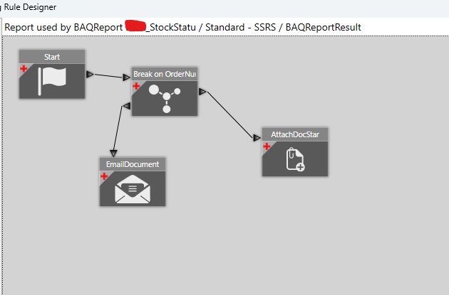

Yes, there are 2 seperate attachments created, 1 the Order Confirmation and a 2nd document which is a custom built ssrs report.
CustomField_c changes to True then the 2 documents are emailed to the customer but also added to the Order as an attachment and I want them stored in SharePoint Library.
The Library is currently working and in use for manually added attachments just not these attachements created by a data directive and Report Style Break/Routing.

Once that check box is set to false the below data directive is run.
The documents are then run through the Routing n Report style.
Which emails and attachs via DocStar.
Thats as simple as i can put the process.

You’re not going to be able to retrieve the files generated in this process, you’ll need to run them again from your directive. (Unless you want to build some kind of waiting / polling thing lol)
You could intercept it maybe in APR by adding a print to alternate report style and catching that condition in a SubmitToAgent call.
Either way, you’ll want to run the generate report again with a RunDirect for easy retrieval, or generate the report once with RunDirect and restructure to send your emails with code.
I do see you are able to use the AttachDocStar widget, which I cannot. If you can use that, we can probably grab it there in a BPM.
