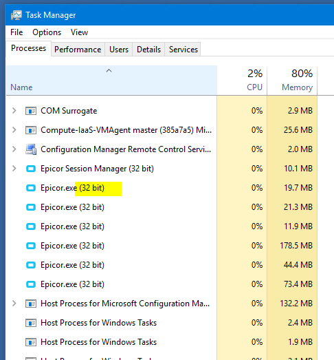

Open task manager on the App server, and look there.
Surprisingly, we’re running 32 bit, even though this was a brand new install just a few months ago.
But isn’t that showing the clients running in 32? Clients could run in 32 or 64 bit mode. I am talking about the main appserver program.

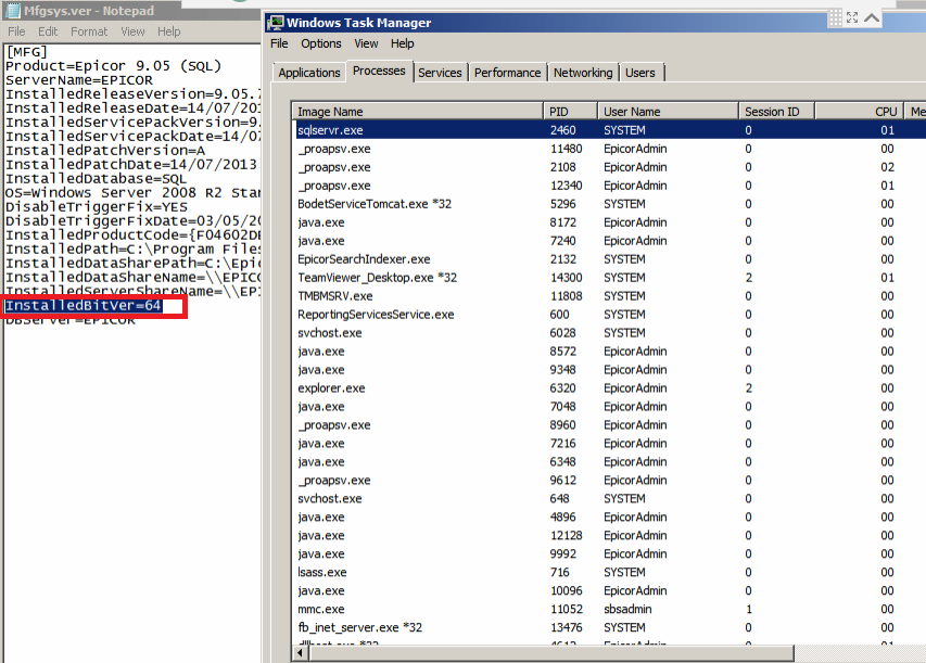

Have a look at the Mfgsys.Ver file in the Top Level folder for the Epicor 9 installation - this file should have a line that states ‘InstalledBitVer’ this value will tell you if this is a 32bit or 64bit install.
Alternatively look in task manager and see if the _proapsv.exe has an *32 after it - if it has then it’s a 32bit install on a 64bit Server.
Thank you sir! This is exactly what I was looking for.
