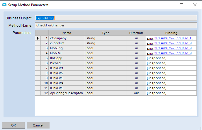

I’m in the process of building a dashboard which will allow users to release jobs from said dashboard. This dashboard is tied to uBAQ where I am running BPMs to replicate the “Release” check box being selected on the “Job Entry” screen.
One of the methods that is called when a job is Firmed (if an unfirm job is released from the dashboard, users would like it to automatically firm as well) is JobEntry.CheckForChanges. This method expects several parameters:
cCompany (String)
cJobNum (String)
lJobEng (Bool)
lJobRel(Bool)
lInCopy(Bool)
lSchedL(Bool)
lChkOff1(Bool)
lChkOff2(Bool)
lChkOff3(Bool)
lChkOff4(Bool)
lChkOff5(Bool)
opChangeDescription (Bool)
The first few of these parameters are self explanatory, but I’m not sure what I should be binding the “lInCopy”, “lSchedL”, or “opChangeDescription” to.
