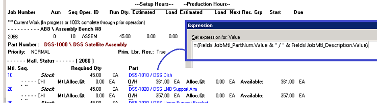

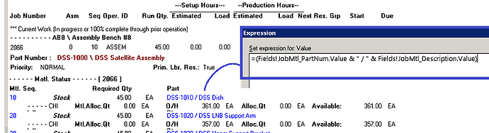

Just curious, how you are trying to display the mtl part/desc in your custom report?
In the standard report I usually select the option “Material Status” to see the mtl partnum/desc.
Ref screenshot from the Educational database
Bruce, this is what I was looking for. In the custom report, I removed most of the fields we don’t need but the 2 we want Mtl part & desc I couldn’t get them display due to that option.
Now I just need to figure out how to get that option selected by default. Thanks Bruce!

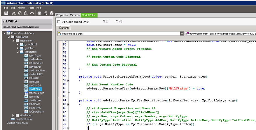

You can try to set it in a form customization - form load (ReportParam epidataview)
Then set the customization on each menu via menu maintenance.
Ref screenshot & there should be several other examples if you search for “ReportParam”
Thanks Bruce. I got that option set in a customization and along with it, I also set the custom report style as the default.
