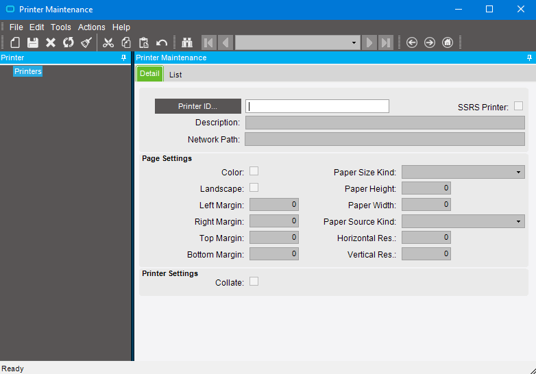

I see that @JeffLeBert answered this one, but I am curious about the margins in the Printer settings:
I donât think the margins are used by PDF reports. The margins you would care about are the ones in the SSRS RDL.
Thank you.
