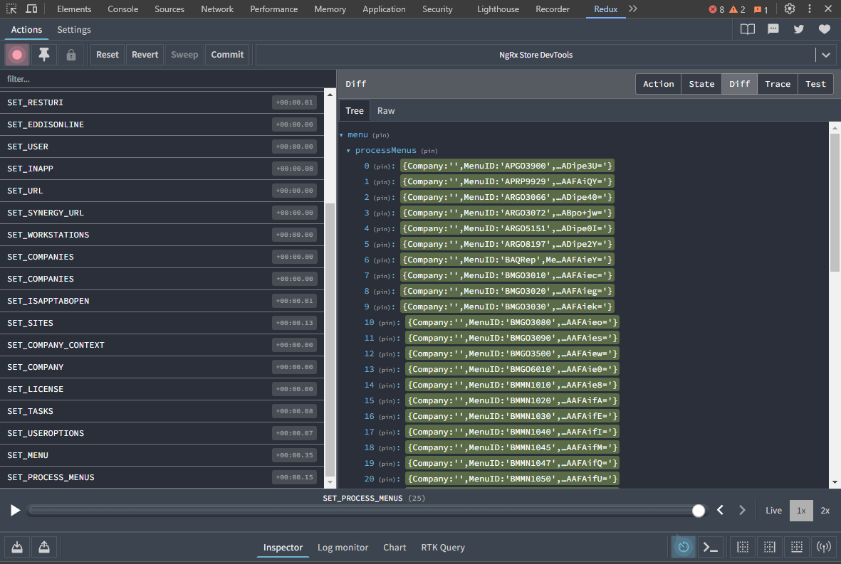

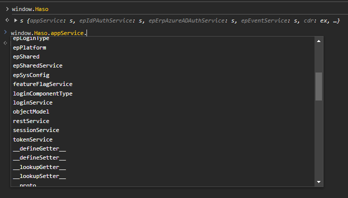

My Insights session "Mastering Kinetic - Development Tips and Tricks"
Great Session @Waffqle_De_LaCroix Kudos! I’ll have to meet you half way and fill in some other tips/tricks for “debugging/sandbox” tagging on to yours, soon. :slight_smile: Well Done!

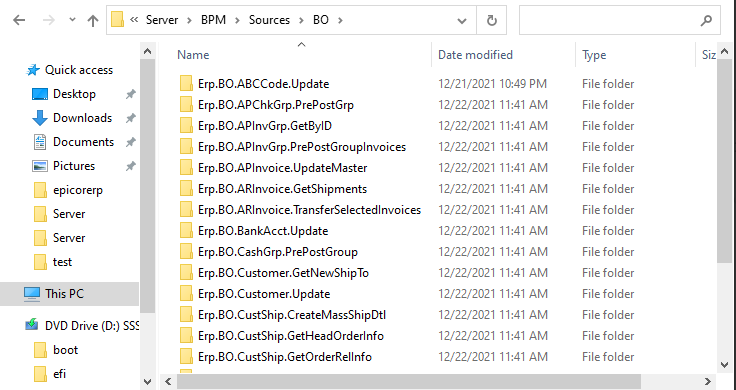

Goodie Related to Sources on-prem

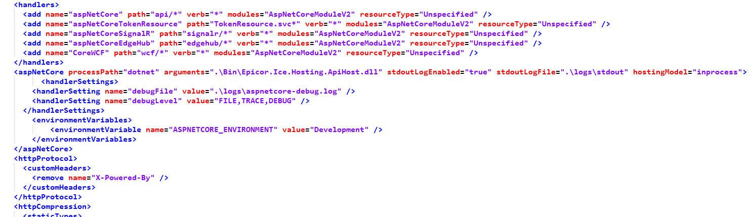

Related to On-Prem debugging if you have Startup issues or want some more in-depth debugging behind the scenes you can enable it in web.config
