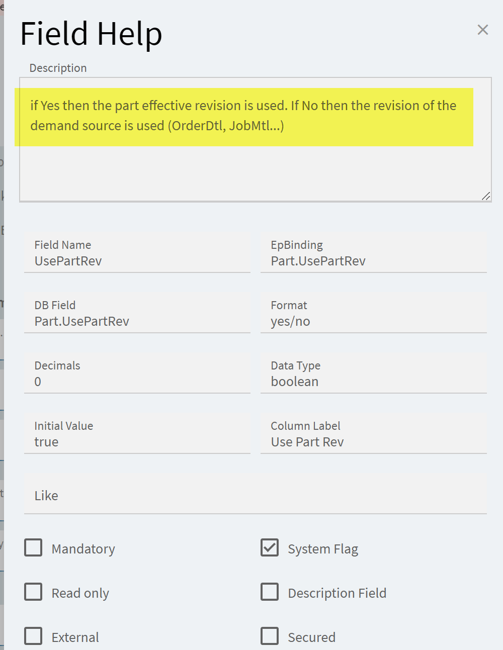

Standard functionality…in Part Maintenance, the “Use Part/Rev” field. If TRUE, MRP will always use the latest approved Rev. If FALSE, it will respect the SO/Line/Rev.
If I understood the question, Frank wants three active revisions, one for each color. Standard functionality would pick the last color approved. Correct?

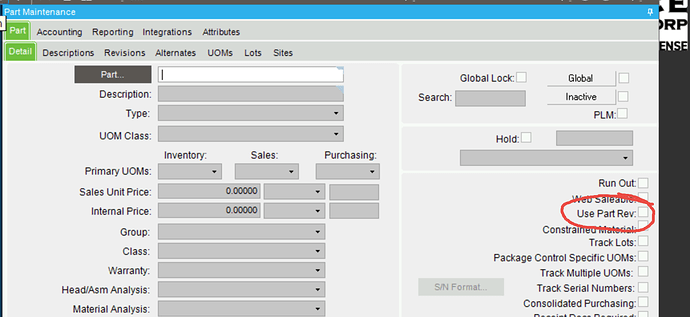

To translate, your “Standard Functionality” = Use Part Rev = TRUE. If you change it to FALSE, and you have those 3 Revisions APPROVED, then you can pick the Revision in each SO line, and MRP will create jobs with the respective revisions.
We have the “Use Part Rev” unchecked and still only getting one unfirmed job for the base revision and we should be getting three jobs. We have three sales order lines, one for each color. MRP is giving us one unfirmed job whether it is checked or not.

So had a session with Epicor Support. We have the part set as non-stock, unchecked the use part rev, changed the dates for each line on the sales order. Ran MRP, which returned three unfirmed jobs based on the new SO Dates. The revision is the list revision 14 out of 14 and not any revision that is on the sales order.
So the behavior that is listed in the help, stating that it should be based on the line revision is not working at all and just taking any revisions it wants.
