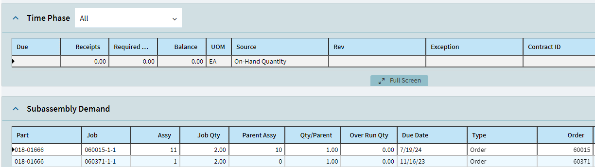

Time Phase can be misleading. It only shows demand for job Materials, or Parts being produced as a top-level assembly. It does not show parts being produced as lower-level assemblies on a job.
I added a new grid to our Time Phase to show parts being produced as sub-assemblies to display sub-assembly demand.
Not that this helps your current issue… but, below is an example.
Out-of-the-Box Time Phase shows (0) on-hand, and (0) demand… but the bottom (new) grid shows this part is actually being produced as subassemblies on a couple different jobs.
