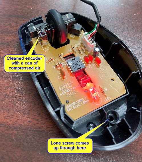

When mice used to actually have a ball, and the two optical encoders, I’d regularly open those up and clean the ball and encoders real well. Now with an optical mouse, it doesn’t open at all.

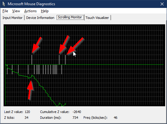

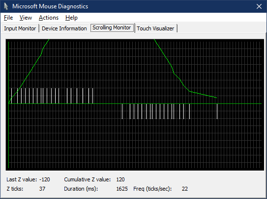

FWIW - I found a utility mousinfo.exe that provides a diagnostic window of info coming from your mouse. It was in C:\Program Files\Microsoft IntelliPoint
While rolling the wheel down(pul it towards me), the Last Z value is typically -120. But every now and then it shows +120 (it doesn’t actually show the positive sign).
Using the Scrolling Monitor tab, and steadily scrolling down I see that some of the movement registers as a +120. This is what must be causing the jumping, as the O/S thinks I’ve scrolled up for a scrolling click or two.
