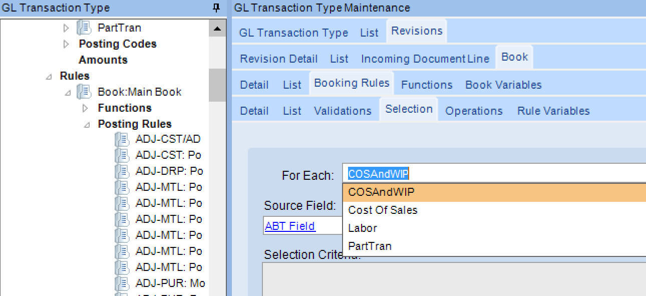

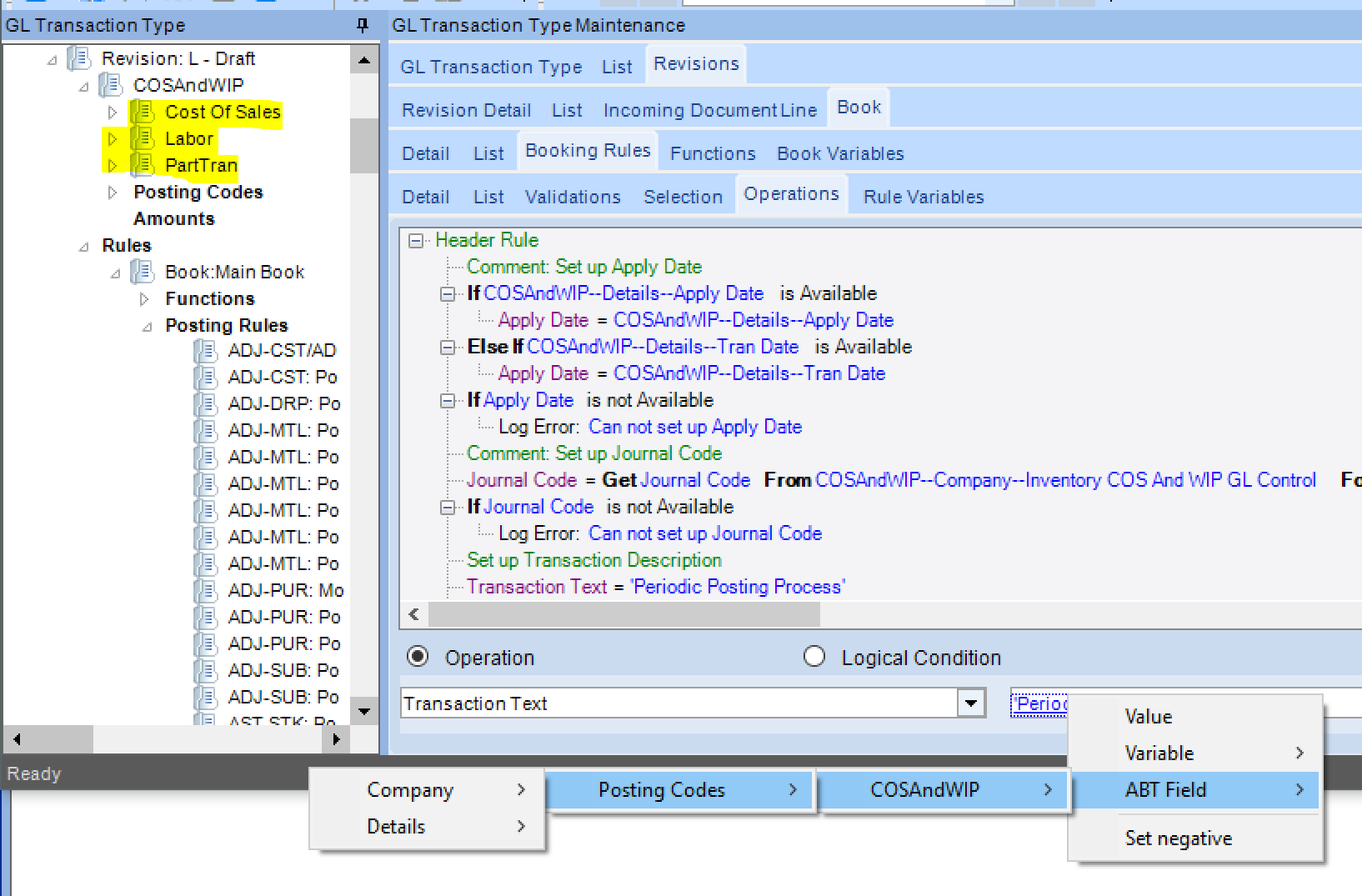

I’m not sure if anyone can shed light on this, or how to make it work again. I’m trying to modify the Header Rule Posting Rule in COSAndWIP GL Transaction Type. However I cannot access COS, Labor, PartTran from the context menu anymore?
It looks like you have to change the For Each under the Selection tab to PartTran and then it becomes available in the context menu.
