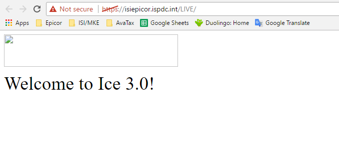

Open https://isiepicor.ispdc.int/LIVE in the browser.
It looks like you will see some yellow screen of error instead of normal data.
Probably error in your web.config

This is what I see when I do what you suggest.
The certs seem fine for now.

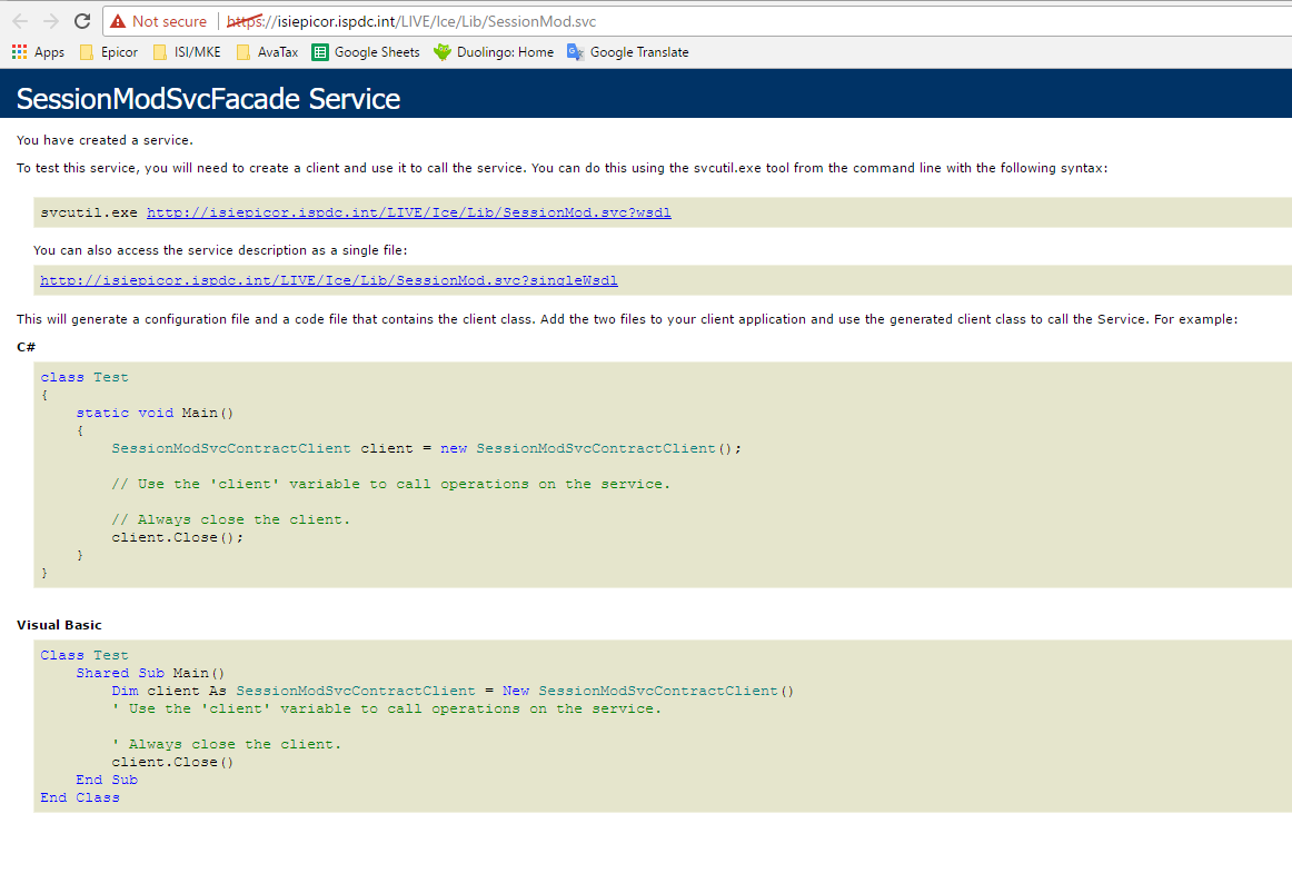

and what the https://isiepicor.ispdc.int/LIVE/Ice/Lib/SessionMod.svc shows?
I am asking because your exception information contains some runtime error shown in html, it should not happen.
Olga,
Initially it said I needed to add a tag in the web.config: < customErrors mode=“Off” />
Once I did that, the link now showed this:
Upon trying to log in, I now get this:
ok, this it correct screen.
So you now need to check the binding in web.config

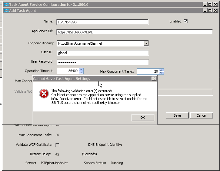

I thought that maybe it was because the task agent was pointing at the SSO task agent, so I tried to set up one for httpsBinaryUsernameChannel, but couldn’t get past this error. Thoughts?

It looks like that you certificate contains isiepicor.ispdc.int in subject name.
You need to use that name exactly in the AppServer URL, not just ICIEpicor.
That is https://isiepicor.ispdc.int/LIVE
I realized that and changed to what you suggested, but the result ends the same.
Additionally, I’m not entirely sure the task agent is the issue anymore since the reports generate fine. It’s just the BPM auto printed labels (using Epicor’s Auto Print widget) that serve up that error.
In any case, the steps are the same - use same URL that written in the cert, whenever you connect.
And, if it is self-signed certificate, you also need to put in the proper certificate storage on the client - so client can trust the self-signed certificate.
