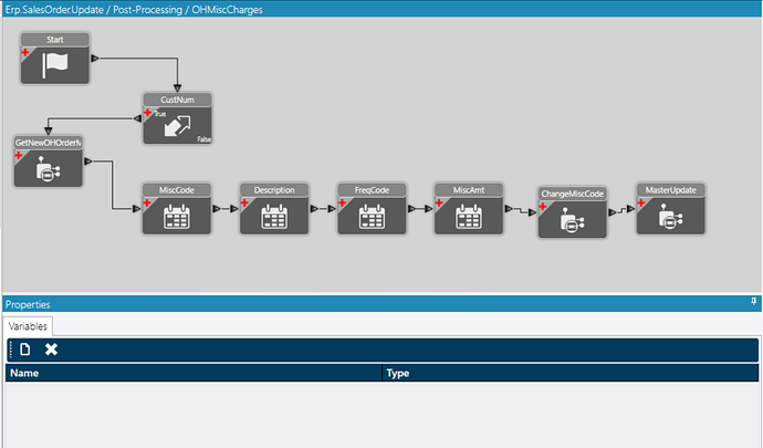

My main issue is that I can get it to create a misc line at the order head but every time I hit the refresh button it disappears. I am not sure how to get it to stay.
Attached is a copy of my BPM, if you have time to look at it.
OHMiscCharge.bpm (35.9 KB)

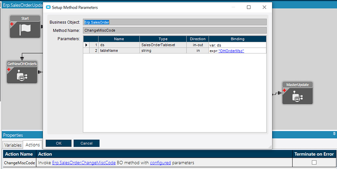

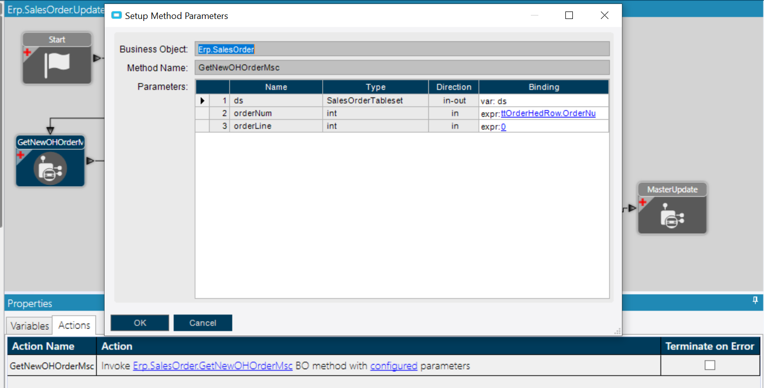

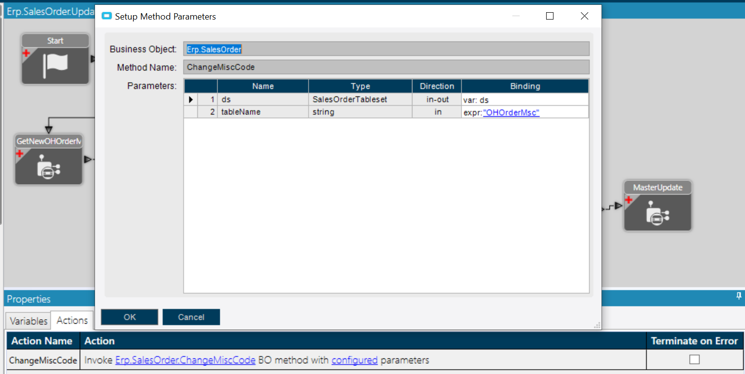

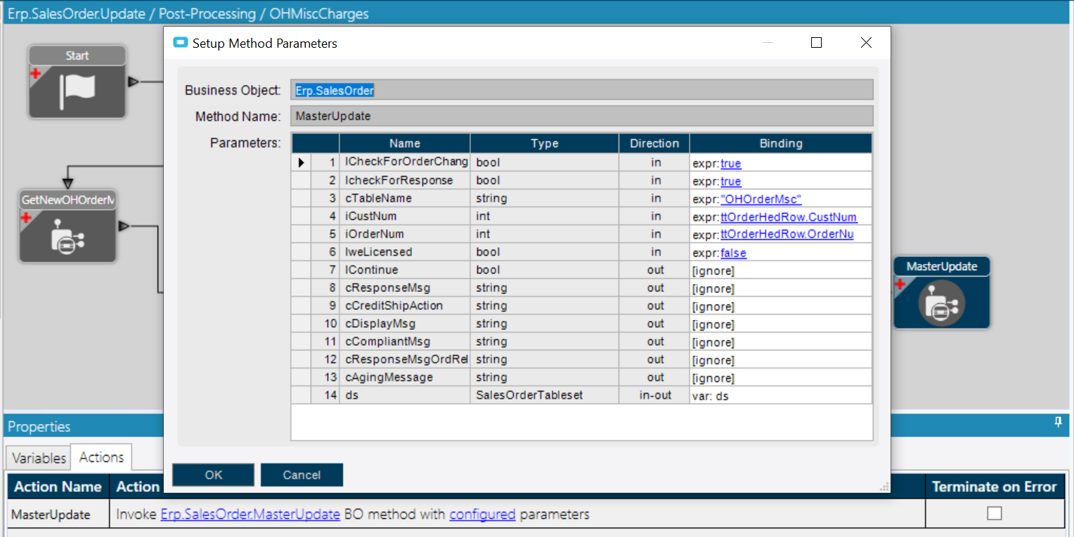

Thank you for the suggestion, to be honest my C# knowledge is non-existent. I tried to add the Invoke BO Method widget at the end referencing SalesOrder.MasterUpdate, but the system times out and forcibly closes the application.
Not sure if it is an issue for you, but keep in mind that the OrderMsc table is used for header and line misc charges. It differentiates them by using LineNum = 0 for header charges.
Thanks, @ckrusen. I believe that I have all that setup correctly within my BPM. I can get the misc line to create at the header level (before I added the Invoke BO Method SalesOrder.MasterUpdate), it just won’t save it and I am unsure of how to get it to save.
I see this message in the Event Viewer and several more relating to w3wp.exe, after triggering the save on the Sales Order- “An unhandled Microsoft .NET Framework exception occurred in w3wp.exe [11836]. Just-In-Time debugging this exception failed with the following error”
Attached is an updated version of my BPM with the Invoke BO Method Sales Order.MasterUpdate.
OHMiscCharge.bpm (42.4 KB)
I don’t have access to 10.2.500, so I can’t see what is in that BPM.
Can you post some screen shots, and any code blocks?

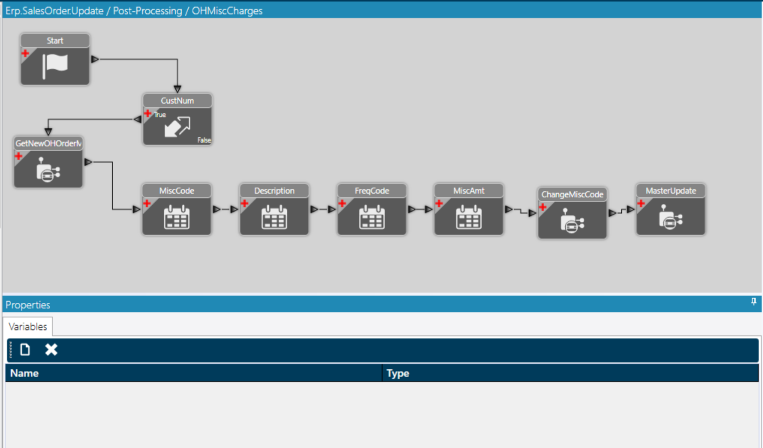

I hope this helps. Let me know if there is something else you may need. I appreciate all the help.
As a no-coder myself, I will say it is very possible to do just about anything using Epicor Functions and BPMs.
I don’t see anywhere in this post where you started with a trace, and that’s step zero. Also, BPMs work fine, but I LOVE using Functions as they help isolate, well, you know, the separate functional areas of your project.
I could be way off here…

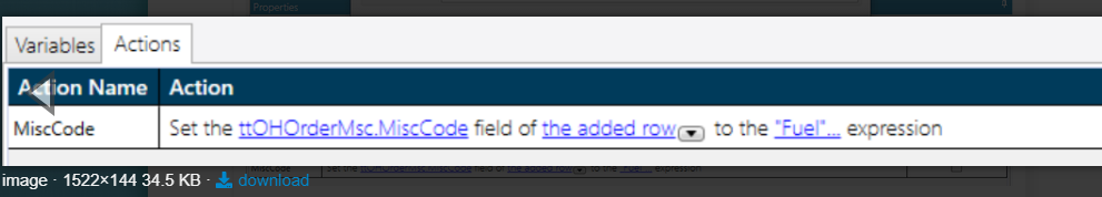

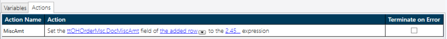

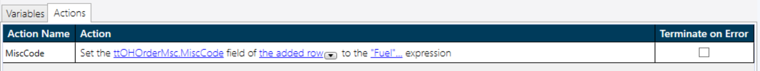

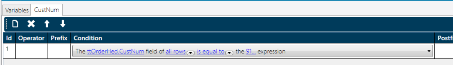

But in the following:
The “added row” is referring to a row that was added, which initiated the Update. And not the row you are adding with the call to GetNewOHOrderMsc.
The above Set Field widget (as you have it configured) will only set the MiscCode to FUEL, of an OrderMsc record that was added to this order. And not one added in the BPM, but one added that caused the Update to fire.
