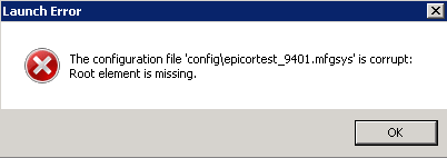

.mgfsys file corrupt
Has anyone encountered a corrupt .mgfsys file where the entire file contents were wiped out leaving the file at 0kb?

Open the config file to see if there are any contents in it. If not, recopy it and it should work.
The .mfgsys file’s contents were somehow wiped out yesterday afternoon so I took a copy of the file to resolve the corrupt file issue.

I made sure the anti virus software had exclusions setup for the Epicor client folders.
Check your firewall and security access to the folder location. We had a virus wipe out and corrupt our files and we updated our security settings to prevent it.
