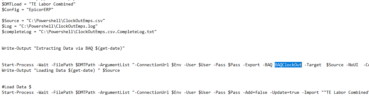

What’s the name of your BAQ I couldn’t find it in your script to change it.
See below

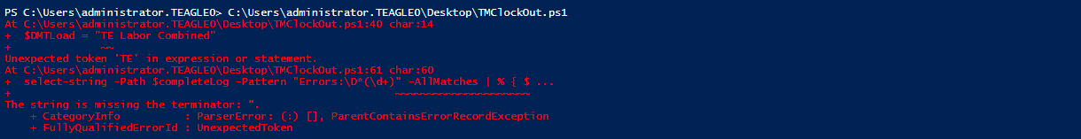

I’m getting this back… :confused:
I think the issue may be the line
$Env = “net.tcp://EPICORAPP/EpicorERP”
Just check the final double quotes is in fact shift-2
Just check all your double quotes
Found the issue. :smiley:
