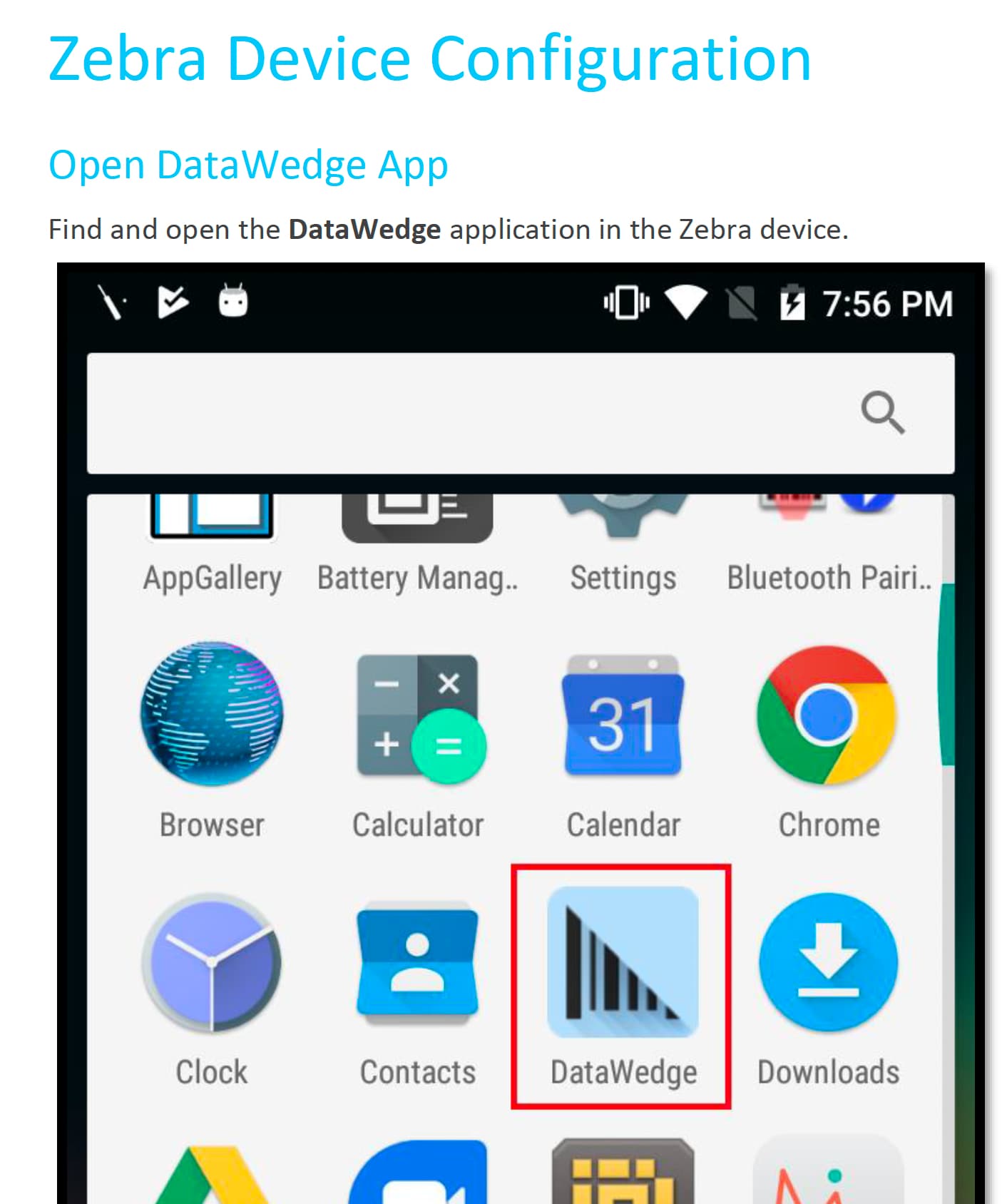

I use to have this, you need configure a Profile in DataWegde please reffer to EpicorMfgWirelessWarehouse _InstallGuide.pdf on epicweb.

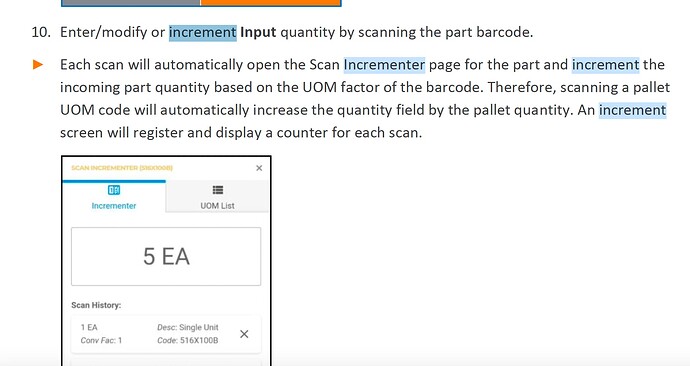

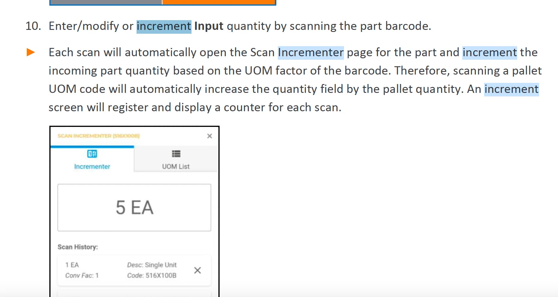

I don’t know if is your case but, I disable de increment counter in Settings too
