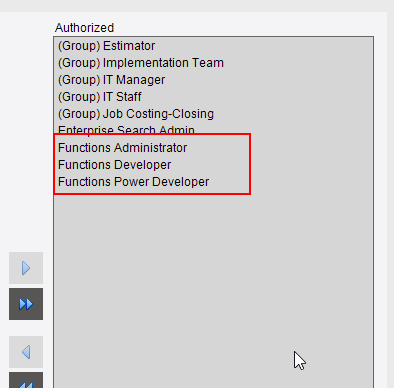

You need special permisions in your user settings (Function Admin) group/

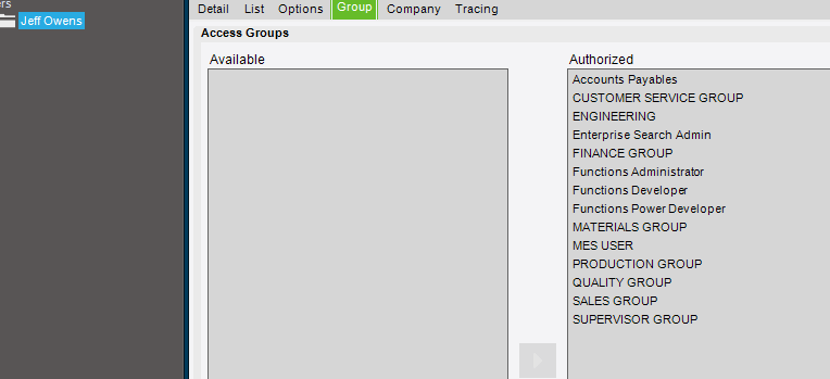

I have access to all the groups and am Security Manager. I only see this…
You are assigned all of these?
If you were not and now are make sure you restart your client or the menu item still won’t show up.
Lean on the Epicor Application help, functions are actually very well documented in there.
I assumed a logoff/change user would be sufficient but no. So also restarted the Client and still no luck. I have all those groups and I still see the same menu options shown in my screenshot.
