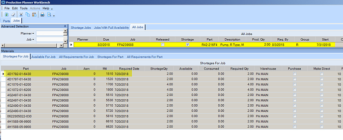

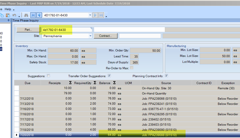

I see you are using the Production Planning workbench data in your note above. Can you provide any clarification on the usability of this data/tool? I am struggling to see how it works. Here’s an example of an error, it claims that i have a shortage on part 4d1792-01-6430, for job FPA239088 but looking at timephase I have 66 on hand at time of job requirement. I ran the prod planner process with cutoff August 31.
Thanks for your consideration!

Looking at your Time Phase I can see you have a min of 60 and a safety of 17. As soon as you go below 77, you need more.
Oh bummer. We have allow consume minimum on hand checked.
So a shortage is any part below MOH or SS? We use MOH to determine when to order again, so it’s a very normal scenario for us to be below it, waiting for parts to take Lead time to come in.
No a shortage is any part below Min QOH PLUS Safety Stock.
