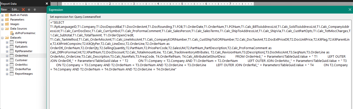

I think I can sum up my opinion in a use case and a screenshot. Have you ever tried adding just a single new table or even field to a report with the SSRS tooling? When you get to the part where you have to open up this gigantic mess of a string that looks kind of like SQL and find just the right spot to add you magic string to inject the new table/columns, with just the right amount of plus signs (+) and double quote (") wrappers, I just felt so dirty. Like a really bad code smell. I’ve only had to do it once or twice (we’re still running a lot of Crystal), but I just knew: this is not scalable, this is going to be a nightmare to debug, and I’m never going to be able to train anyone without some serious programming chops on this. (Okay, to that last point, I’m strongly in the camp you still need software dev types to use most lo/no code tools, doesn’t matter how many widgets you wrap code in, Betty from accounting is never going to understand even where to begin with them.)
The screenshots worth a thousand words:
:nauseated_face::face_vomiting:

Your example illustrates that the specific report is bad, not SSRS… There is nothing preventing you from properly formatting the query so that you can copy and paste it in a text editor and easily edit the query. It’s just that Epicor did not do that on their stock reports… It’s a SQL query formatted in a VB string.
Could it be better? Sure. It could have a query builder tool in there… Is it absolutely needed? No, definitely not…

I have to agree with @HLalumiere , every report I touch I go into the query and format it. The formatting stays so the next time you don’t have to. Should I have to do this? No, but it is a minor inconvenience that makes my job easier. I wish Epicor had done this up front.

I’m not really a huge fan of query builder tools anyhow, let me just write the SQL directly for sure, or point to the XML, whatever - but with something that gives me strongly typed results with error checking (Crystal / XML) or at least syntax highlighting and auto-completion, something modern. Even if the SSRS report design tools had such a thing, the whole “manually concatenate a GUID onto the end of each table name as a string” thing would probably break that. But sure, maybe if I took the time to fix formatting (as much as possible), copied it into VS Code to edit it, renamed all the T1, T2, T3 references, etc. - might make it a little less :face_vomiting:, I’ll give you that. :slight_smile:

It’s a dynamic SQL query. Which, yeah, SQL sucks at variable table names and having to make it a text string where you inject your variables into it is one of the great sins of technology IMO. That’s more of a general SQL issue.
For Epicor specifically, the whole Tn aliases are even more annoying. It obfuscates something that should be pretty clear: table names.
